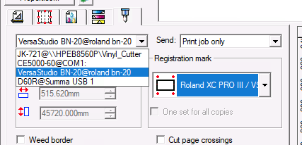

But of the crop marks on either machine are different. Does anybody know how to either?
I was thinking that maybe Flexin would allow me to download the printed file with the crop mark so Roland could print it and then still use the Cutter ??
I was thinking that maybe Flexin would allow me to download the printed file with the crop mark so Roland could print it and then still use the cutter??

The Cropmark is depending on the selected Cutter . Finding the correct color Profile for the Roland is the worrying part.

I have not had luck with Flexi and there profiles, so I use Flexi to add marks, then send to Versaworks, then let Roland versaworks use their icc profiles.
I Print with marks on a Roland and then cut with a Summa, but its the same process.

Thank you for responding Ronny, So yes it's all about getting those crop marks to be read. I know how to draw a few lines like it shows, but I was scared that just drawing some lines wouldn't work. But with the flexi program I was able to load all my printers (Mutoh and Roland) and this way I can tell it what I'm doing and it worked.. which is great for me.

In flexi, when you add the contour cut, it adds the registration marks to the print file.
