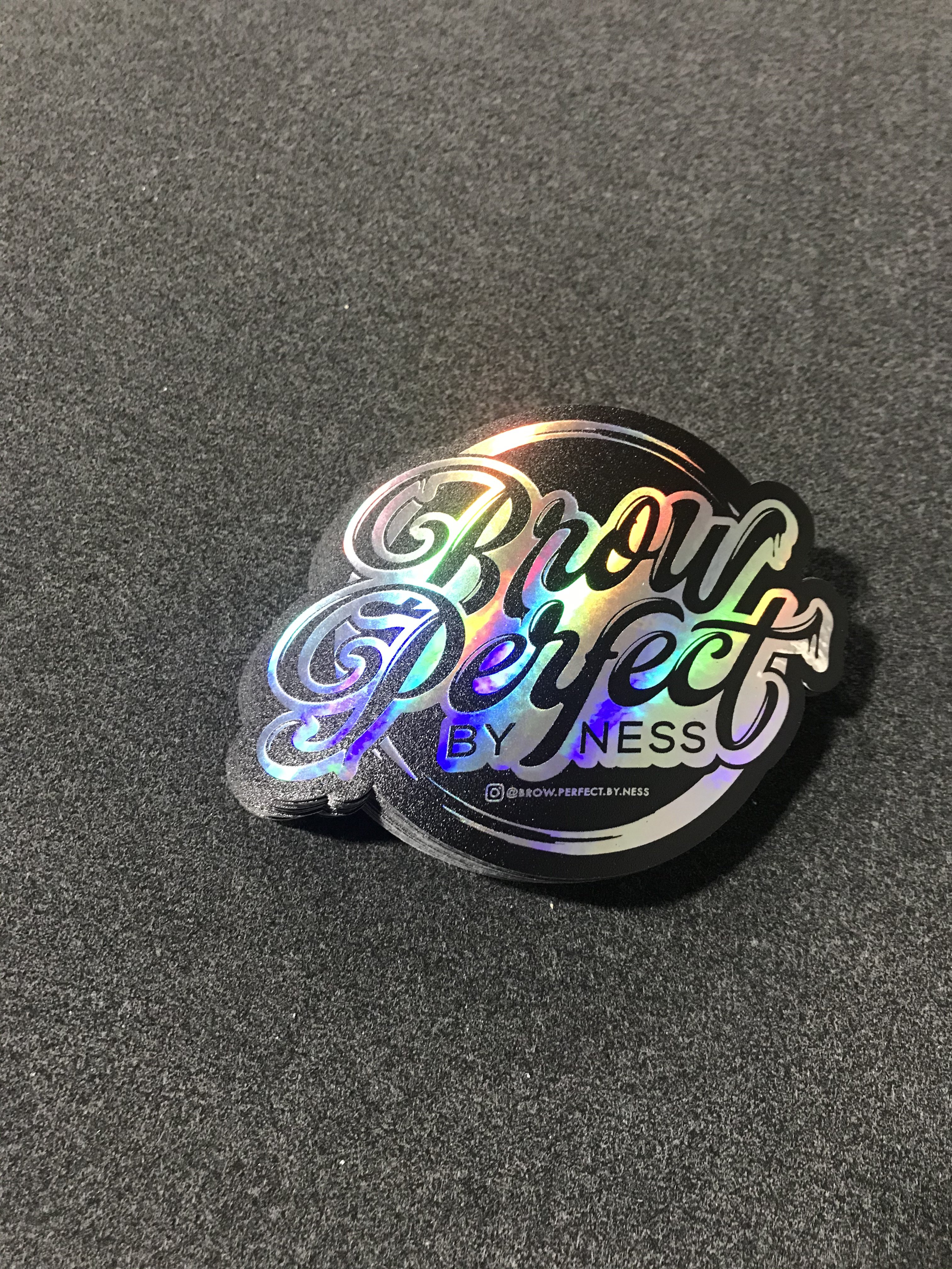

Greg Kelm
www.cheetaprint.com
Find someone to print them UV and avoid the headache...
