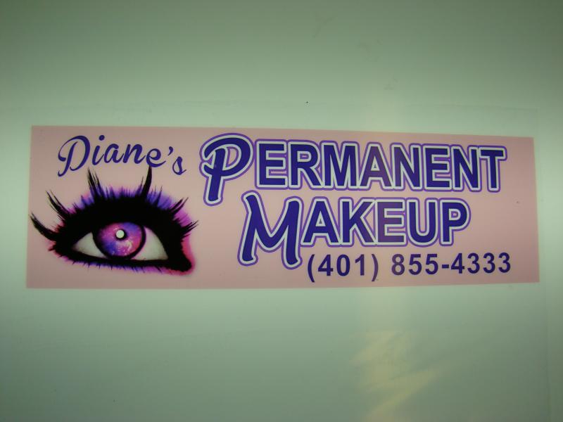

I use Oracal 3651 transparent, print 2 passes with a half second delay between each pass, then laminate with 210 and apply to translucent white polycarbonate.
Here is a 12" sample i made today to see if the colors looked good and if the black was opaque, it is now being printed 10x3 foot as I type this.

I need to bend some ears. Anyone have issues with edge curl on print/cut translucent? wasn't heavy saturation at all, since i used the clear print 2nd surface technique to beefen up the colors when lit..
Same here, 3651 Clear with 210 Lam. But we print using uni-directional with 1 overprint. No need to wait between passes etc. Just make sure the post heater is nice and warm so it dries before you start rolling it up.
We wait a full day before laminating cuz there's super heavy ink.
