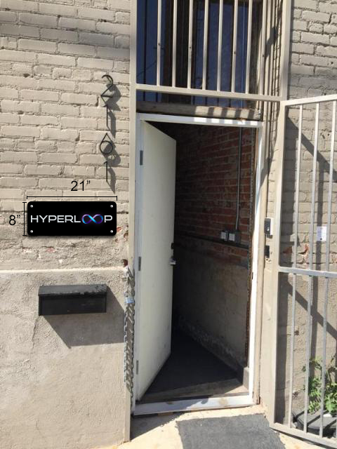

I have an order for a small exterior standoff mounted plaque. I was thinking of reverse uv-flatbed printing this on a clear 3/8" acrylic to have a nice glossy face with polished edge and also protect the graphic. My concern is that the reverse-printed graphic may be overexposed to the elements. Any other suggestions on getting this done? I want to stay away from printing on adhesive vinyl.

thanks for the info guys. After reading the replies, I saw that the biggest thing to look out for was the expansion/contraction of the acrylic. Having done previous exterior signage with this material I feel pretty confident in having no issues with that. As added precaution I will drill the hole slightly larger than the threaded standoff. I also opted to reverse printing on clear adhesive and mounting to second surface over direct printing due to printer limitations. It will be backed with white vinyl. Have a nice weekend!
