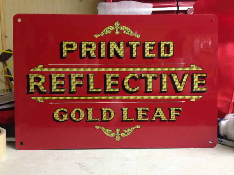

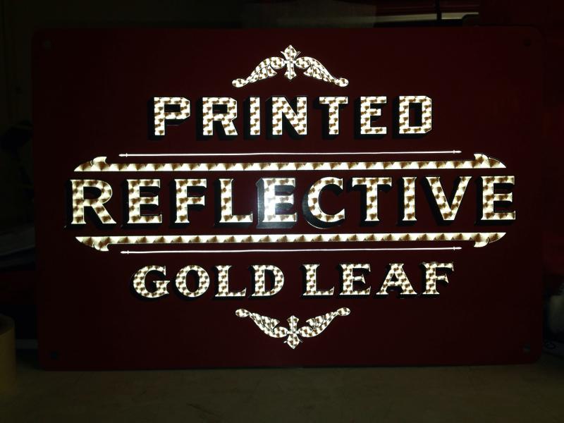

It seems like I am constantly being asked for a more cost effective alternative to hand laid gold or RealGold vinyl. I have always refused to put the imitation gold vinyl on fire trucks because it just doesn't hold up, so that isn't an option. So the only other solution I could think of for this problem was to print something that imitates gold leaf. I know there will be some people that aren't happy with anything that attempts to imitate traditional hand laid gold. I definitely try to push people to stick with real gold, but sometimes it just isn't an option.
I bought BD Sign Supply's custom fills cd which has several engine turn fills on it. I then used one of these fills and printed onto Orafol reflective vinyl using my Gerber Edge. My opinion on the result... It doesn't look bad. Obviously the Edge is not a high resolution printer but it actually looks very convincing especially from a couple feet away. The bonus is it is highly reflective at night. I just thought Id share this to help someone that may be having the same problem I was. I can't remember what the pricing was on the BD fills cd, but it wasn't bad considering what all you get.

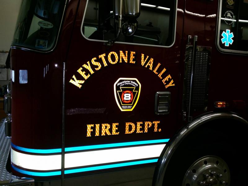

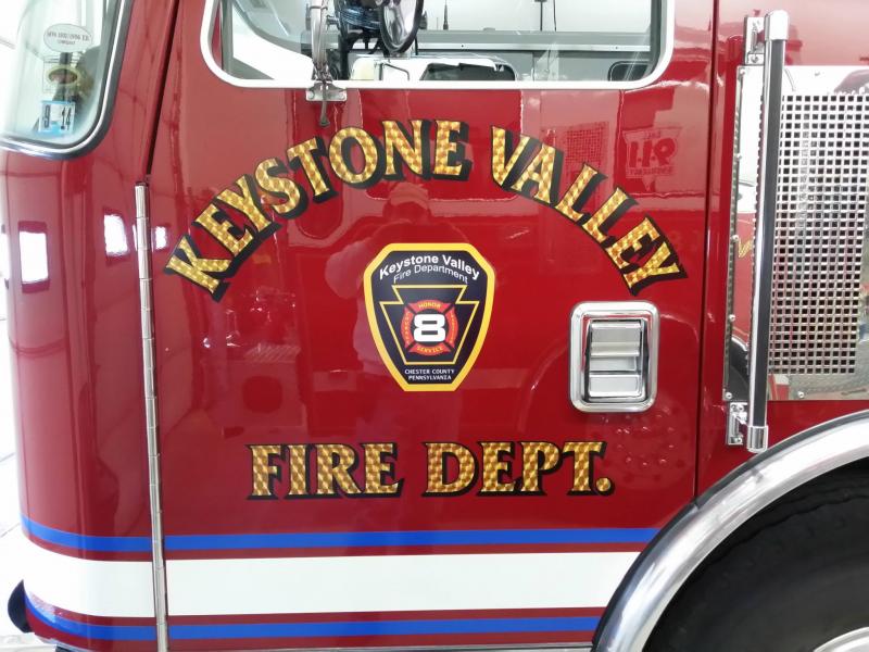

Been doing that for a couple years now. I wound up actually photographing a sheet of the imitation gold and massaging the image to fit whatever I was doing. I'm working on a way to have the turns follow the letters like a traditional hand-turned letter would do, but for the moment, my clients seem to like what they see:
I'm going to have to try Bob's suggestion on the silver... interesting choice!
