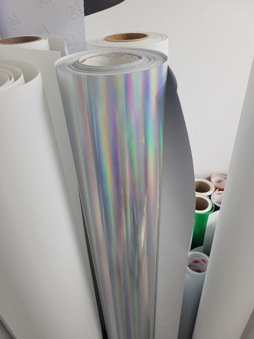

I've got some smaller width holographic in stock. I think it's 14" off the top of my head.
If you don't want to outsource, you can buy it from Halliday Digital. Tell Dan I sent you.
