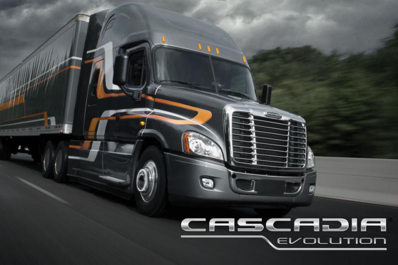

Most of the trucks will be like this

Thanks.
My main question was about air release?
Is it necessary? Or I should be good to go without it?
MrSalumi
Air release is just a matter of preference. If you like installing it with RA use it and vice versa. I personally like using RA and for the minimal cost difference it is worth it to me to stock RA material. I use Oracal too
