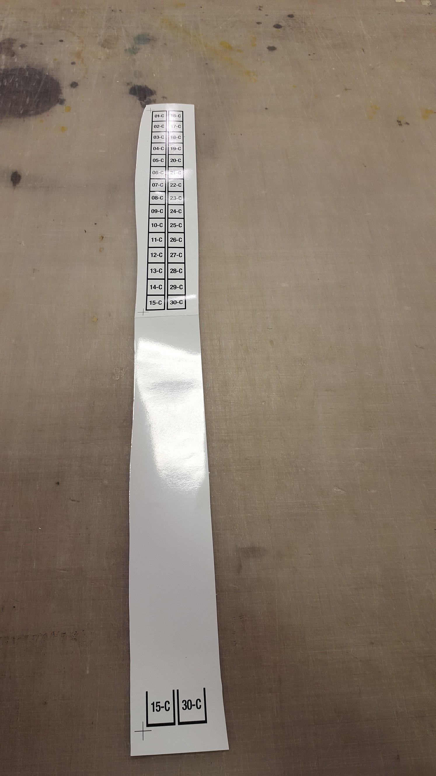

ikarasu
So, just an update. I have about 10000 15" x 2" decals to run, so I wanted to print one out to make sure it's printing / looks good. My EPS file is 27 some up, so I went into onyx... Cropped out everything but 2 decals to print, and it did the same thing.
The decals are 1 color, so it's not dropping colors. It seems like when cropping the image, it's throwing some of it out. Theres no way in onyx that I know of to even make it do what it did... I re-examined the file under buffered jobs, re-put it in queue, and this time it worked perfectly. Heres another pic -
I'm 99% sure it's because I Cropped the image... Even though I was nowhere near what it dropped. The last image I did I cropped a color bar off of the side also - and somehow stuff in the mid of the print is getting deleted. It's weird since I've cropped thousands of files this way, and it hasnt been a problem. At this point, I'm going to presume it's a problem with onyx 10, a bug of some sorts, and upgrade.
