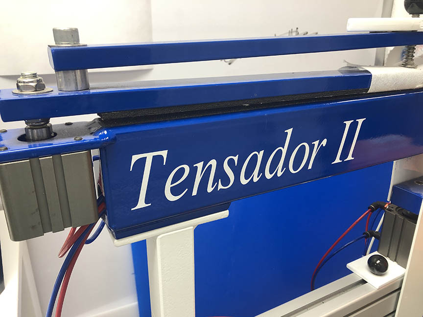

I use a Canon Pro-4100 for my fine art printing and love it. It never has head crashes, streaking, or other problems. Very low maintenance. I had a Canon iPF8400 before buying the Pro-4100, another great machine, I got about 10 years usage out of it before it started to go. Mostly run canvas, textured watercolor paper and smooth archive print paper. Used GoFrame & Stretcher Bar Depot (until they were bought out by Imageworks Supply) ...recently I started making my own system using 10' sticks of stretcher bars the ones I use are Kiln dried Poplar with a slight edge on both edges to be able to use as standard canvas mount (.75" thick) or as a gallery wrap (1.375" thick). I either stretch them by the GoFrame technique, or using my Tensor II Stretcher machine if there are several of the same size.str

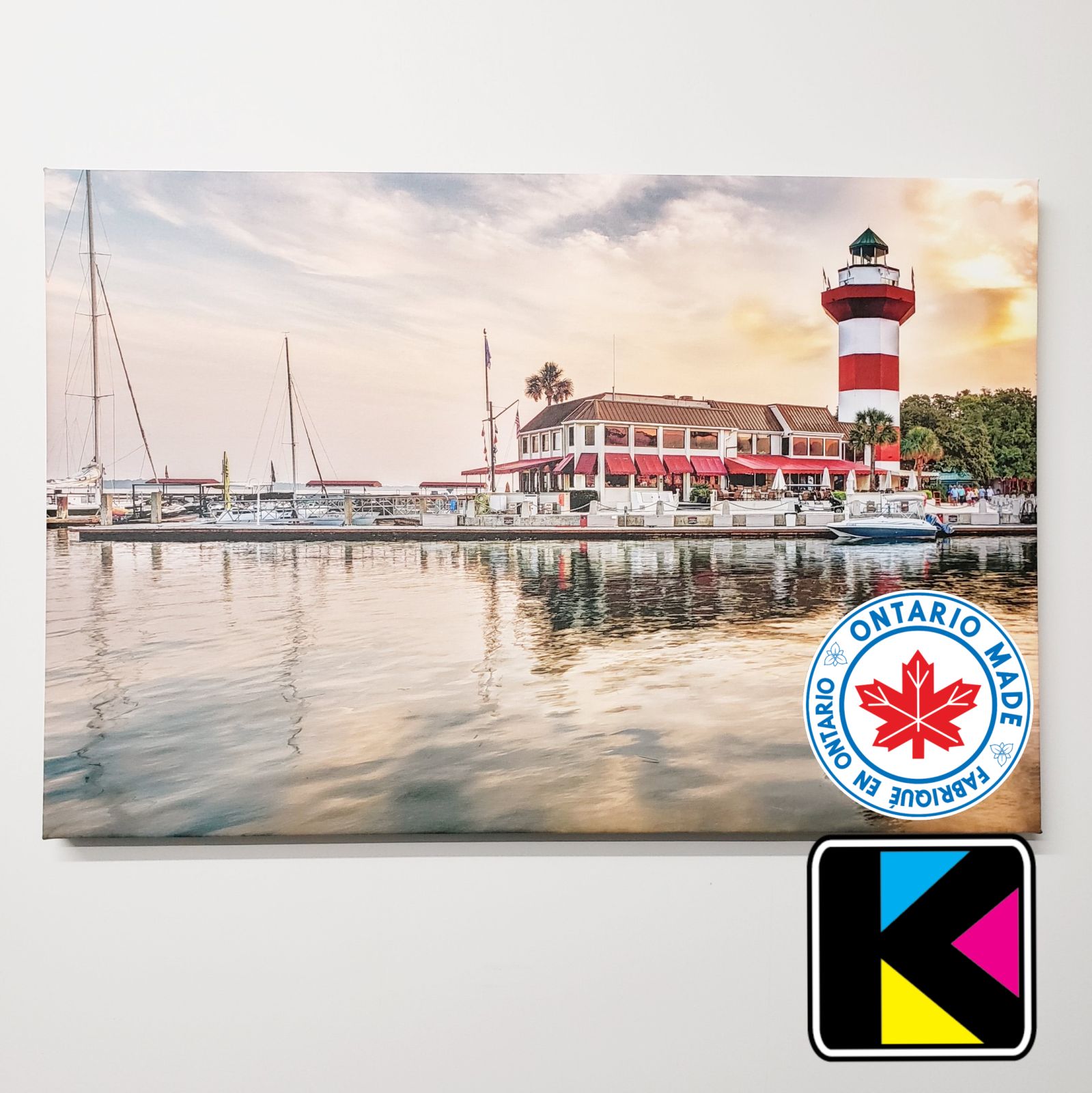

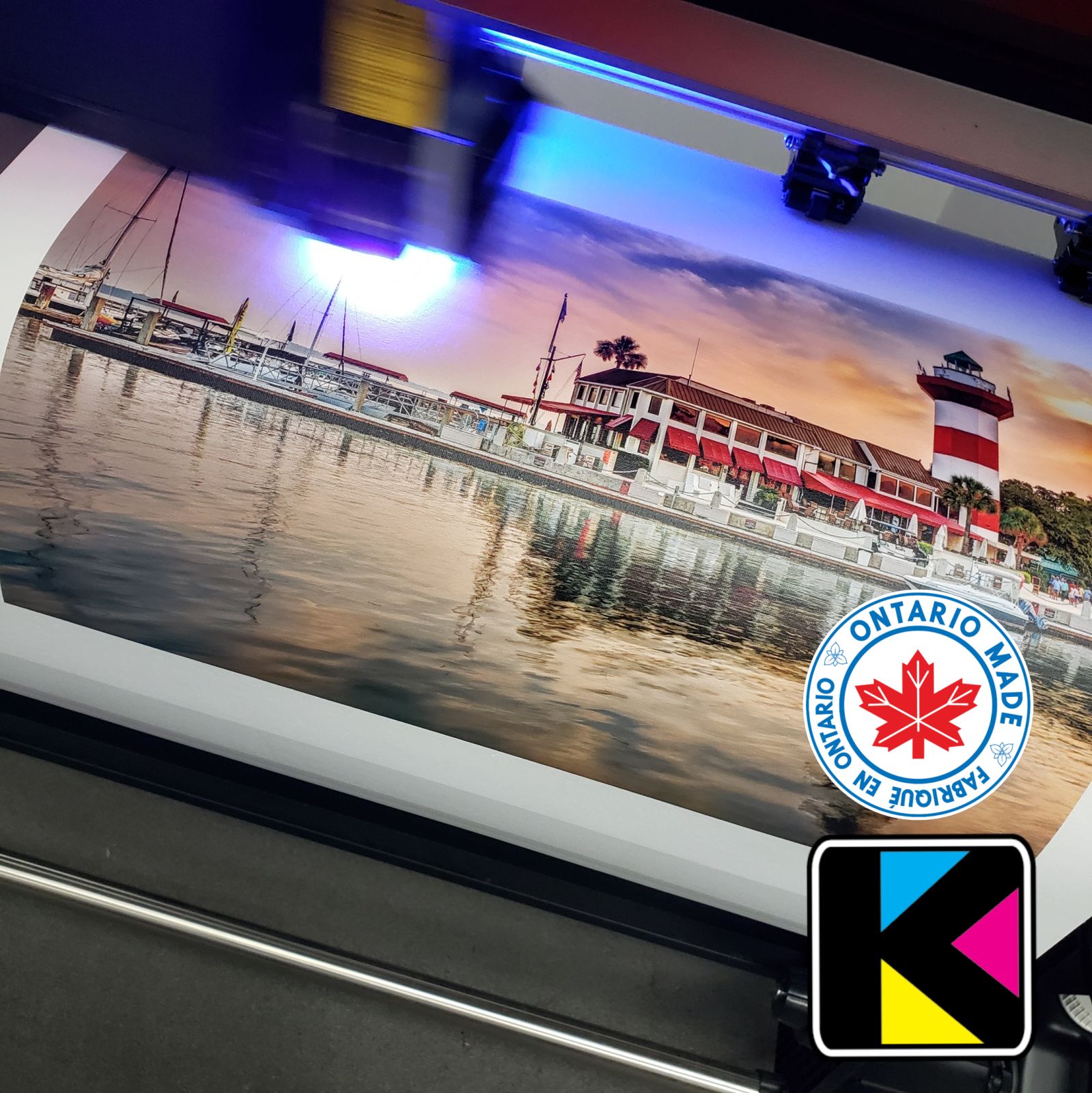

Kemik
I sell stickers and sticker accessories.
I printed these on the Mimaki UCJV with a Matte UV clear coat in single pass. You can also do Glossy UV if you prefer.
