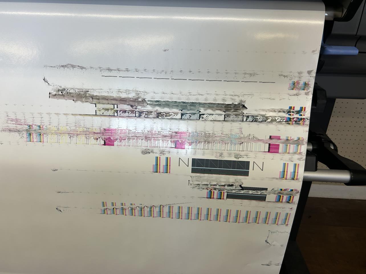

Well, I have a bad head so I changed it. It's still doing this where it prints fine then suddenly starts smearing. I also changed the maintenance cartridge as it was almost ready anyway.
I'm guessing there is something caught under the cartridge, maybe a piece of paper or soemthing? I did't have a jam recently so not sure where it would come from.

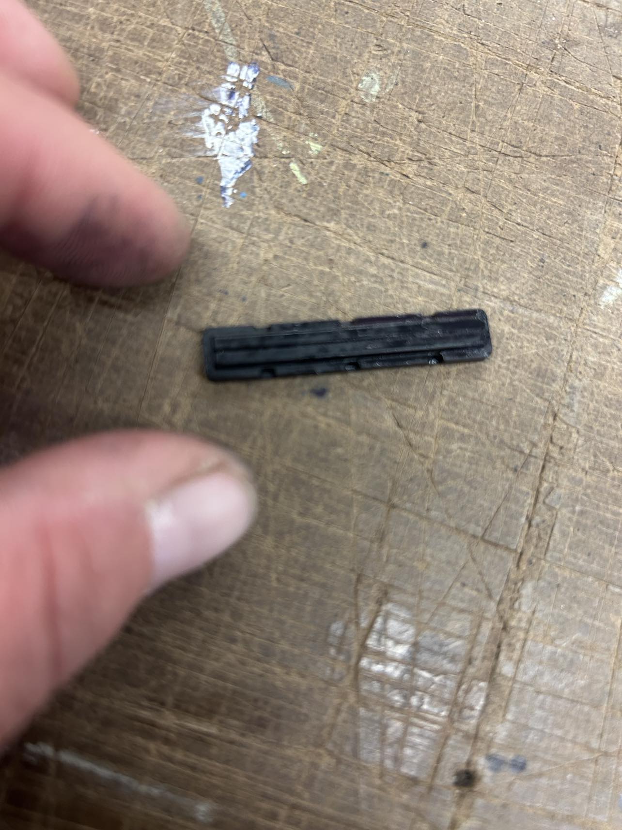

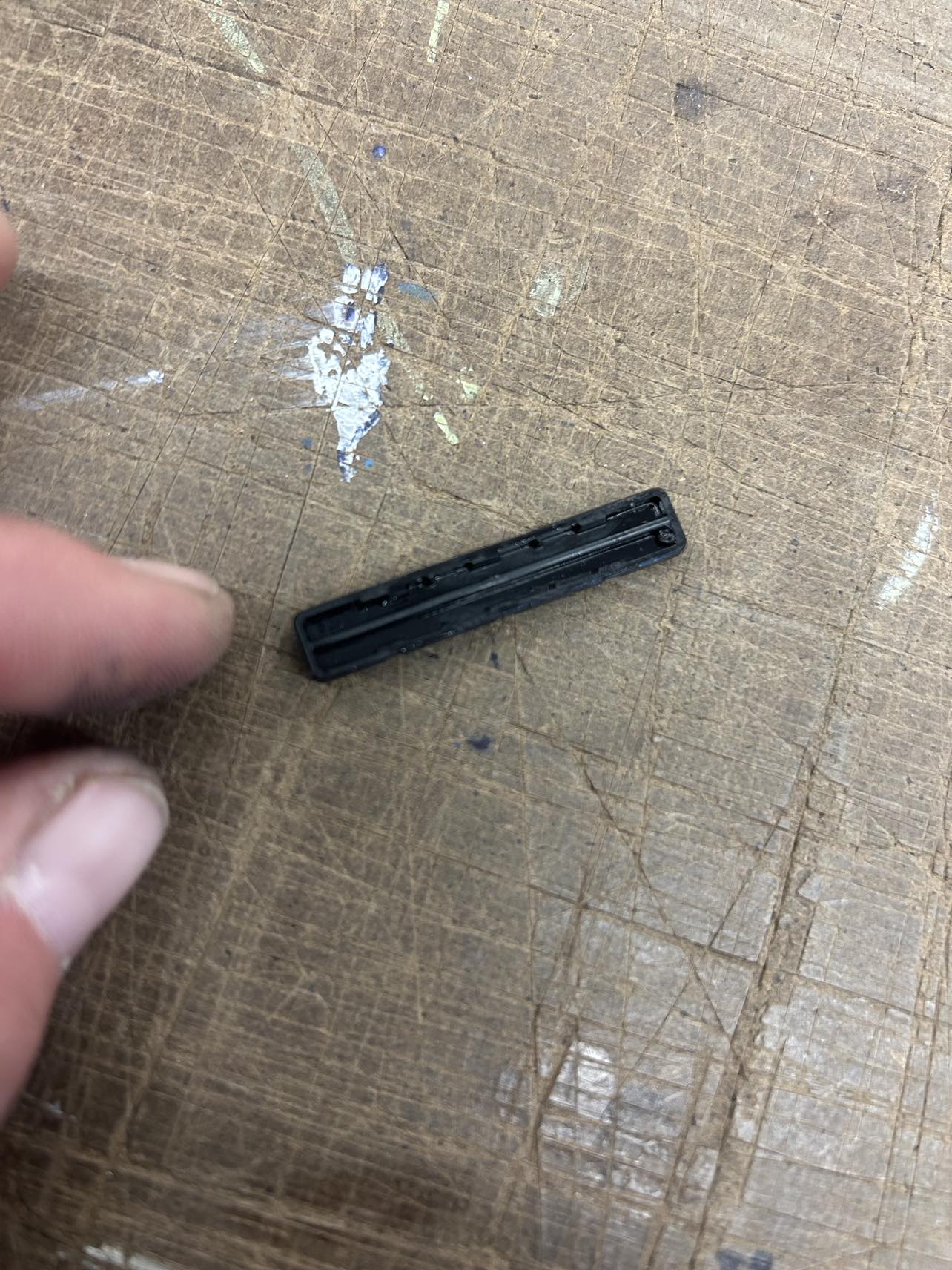

So, not sure what this is from...but this was hanging so I pulled it off. Could it be from the maintenance cartridge? Not sure but it seems to be printing fine now! I ran the printhead alignment, and so far so good!
