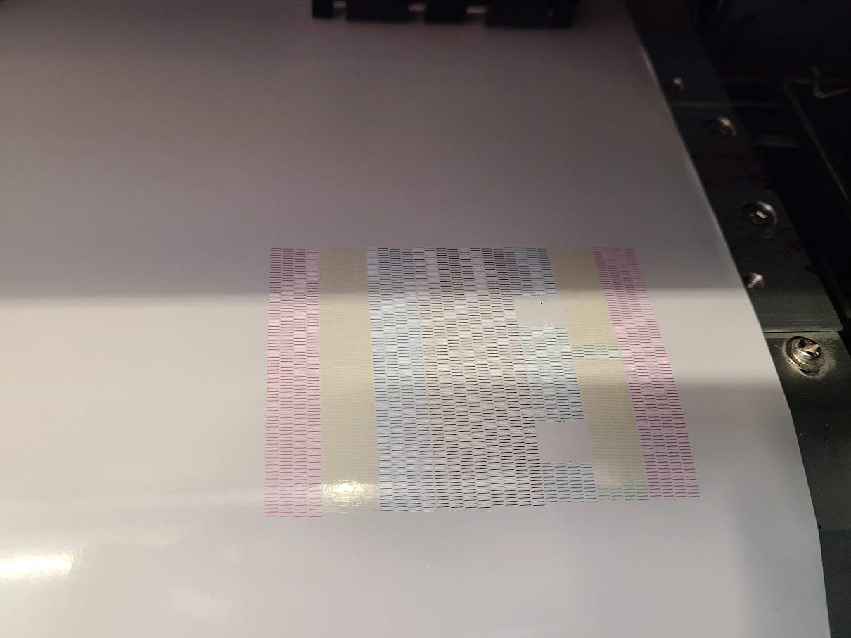

What the heck causes this? An what's the fix? It's a RF-640

My first thought was a bad cap top or clogged pump tube but since all the nozzle are perfect except for cyan and yellow, I'm leaning more towards a bad damper or the head is damaged internally. If the dampers are older than 1 to 2 years old, that would be the more likely reason. If the damper doesn't fix it, the head is probably damaged internally. The cyan is getting into the yellow which either means the cap top isn't draining properly, the damper is not regulating the pressure properly, or the barrier between the channels has broken and the ink is mixing.
Joe House
Sign Equipment Technician
I agree with Solventinkjet, but I always start with the cap top as there's less potential for damage to the print head. And make sure you're getting an OEM cap top. This is assuming that you haven't already replaced the cap top (with an OEM) in the last year.
Then try the dampers, but also take a look at the bottom of the print head. Sometimes you can see physical damage that would point to a bad head.
