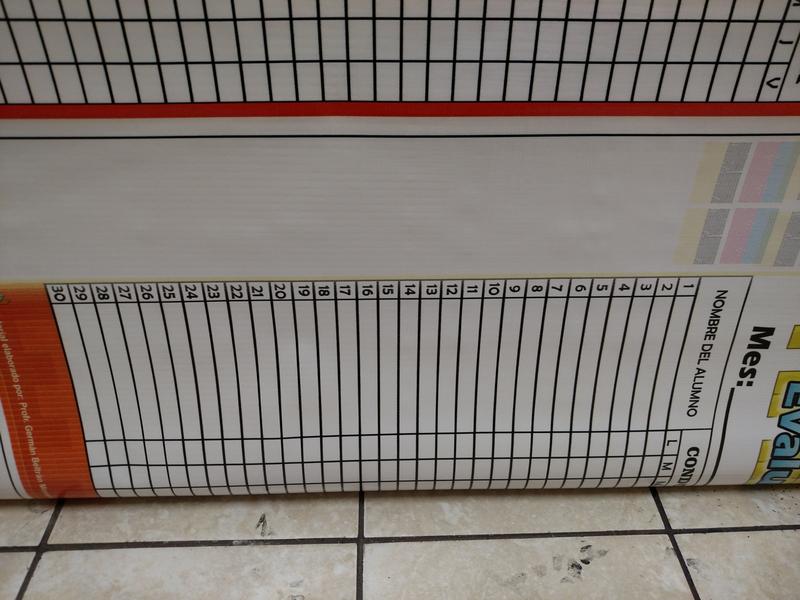

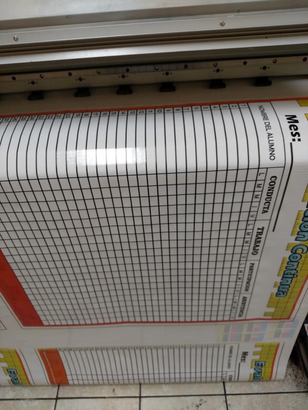

It looks like the fuse it burned (from my threads before), somehow it affected all the machine, looks like both light cyan and light magenta are not working, the group b fuse wasn't working, but got it repaired. The printing quality looks grainy, as if it was printed in low quality even though I use the versaworks regular setup (banner setup with medium quality, when using flex banner rolls) like I used to do it. Now another problem I have is that when i'm printing a 80cm x 80cm it stops and says that the temperature is too high. Any clues on this matter?

The colour pattern on the nozzle check looks like it's missing group A. Should be CMYKLcLm from left to right, i only see 4/6 groups. All heads have a thermistor on them, although the printer only refers to one. On early pro 2's it was black, but i think only because that is head 1. Head 1 on your machine would be Cyan, which isn't present in the nozzle check, likely meaning there is no communication with the main board from there.
A blown fuse would cause that, or a bad cable connection. A bad connection could also blow the fuse, so fixing one might solve the other.

Thanks for the prompt reply, i'l revise the connections and verify that the fuse is correct, i'll let you know what comes out. Thank you for your help.
