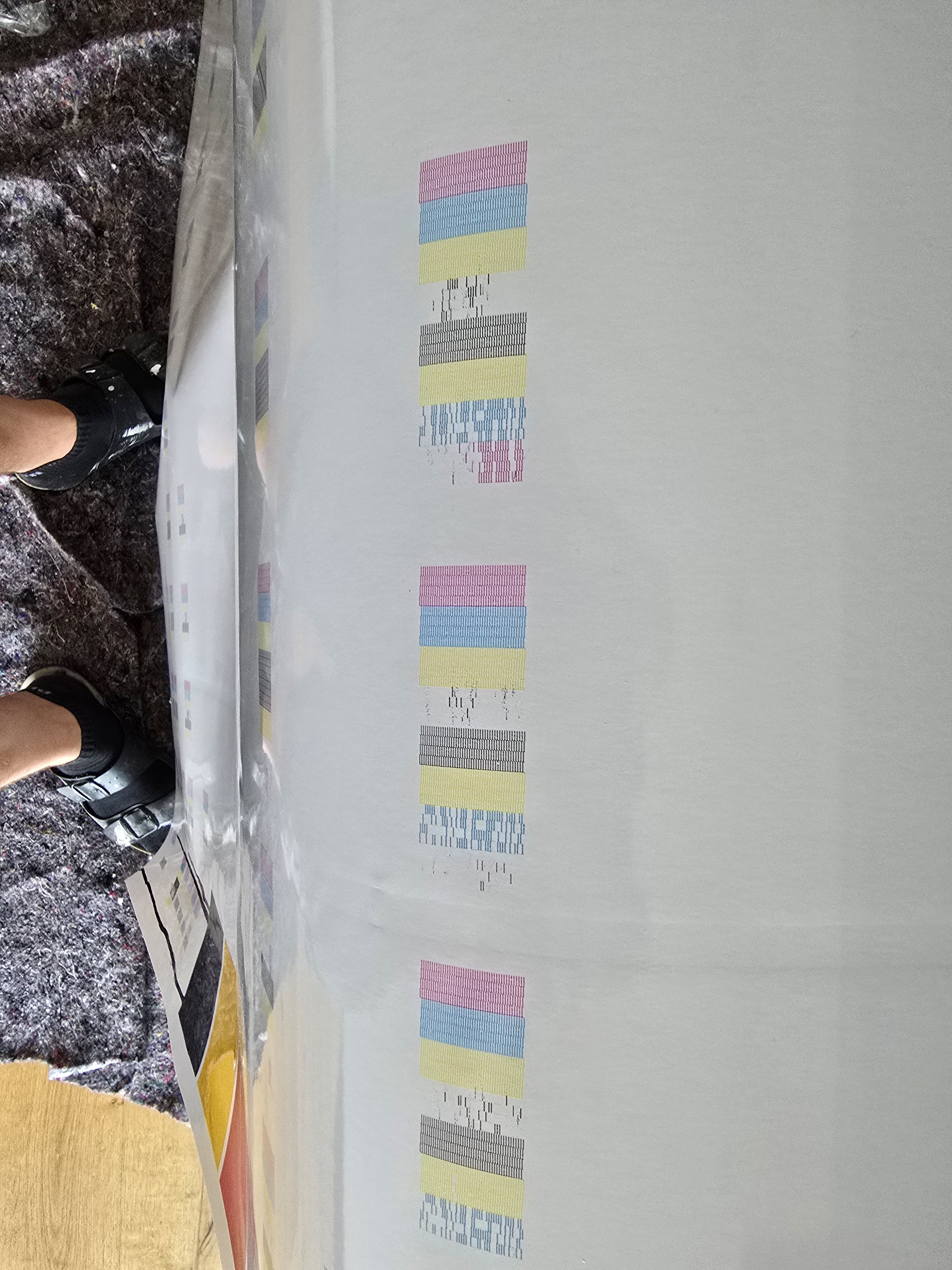

2. The initial nozzle test looked semi-okay: CMYK showed, but magenta produced zero droplets. Cleaning cycles did nothing.
3. After removing/reinstalling the damper to inspect, **yellow also stopped working**. Further cleaning left only black ink functional; all other colors vanished.

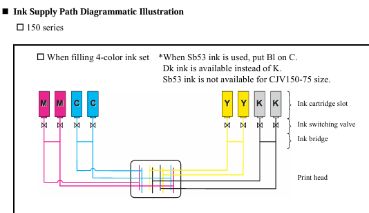

When doing 4 color, the cartridges deplete one at a time, allows hot-swapping. You're fine. Just need to install the line bridge connectors that common the like-colors together.
Smoke_Jaguar
Note how the M is bridged to the other M, Y and Y, C and C, K and K, if those junctions are not installed, you're going to have nothing but headaches.

Thank you guys, i did not install the bridges between the tubes, so it just printed whatever tube was filled allready and i got mixed results whenever i changed ink cartridges and i have lots of air in some of the tubes ....

The bridges between each tube were a gamechanger, now i have 6 from 8 colours, sometimes even 6.5 colors...
And i think the blue damper is damaged, because it sucks the air in when blue should be printed
Thanks again, i think i will get all 8 colors in a few days

Yeah, those bridges are critical for four color mode. Ends up being nice having a cartridge buffer on each of the 4 colors. Can run only 4 cartridges and be fine, great for when waiting on ink to come in.

Thank you so much, just a tiny bit, just had 30 minutes with the printer today, changed 1 Damper and now it prints like thid with 1 time of ink fueling
I'm 75% sure its just air in my channels.
