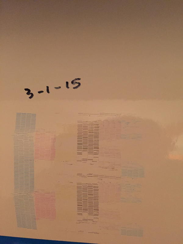

Brent, printer has been sitting for a long time and printhead is plugged up. I changed the dampers, captop, felt wiper and wiper scraper. Drained white and metallic ink out and replaced with cleaning carts. Nozzle check is a little better but tired of messing with it and getting little results.

I've replaced all damper , felt wipers and captop and do a lot of head soaks and still not getting a good nozzle check.

Well then, it just may be time for NEW heads, instead of paying someone $300 per hear and no guarantee they can recover them? I would just purchase the NEW heads and replace them myself....

Well, I have NOT done that personally, however I have read that others have done it and it worked, the think I remember MOST is you need to pull very SLOWLEY so not to hurt the head. Looking at your nozzle test prints your heads look pretty bad, so I don't think you have anything to loose. I would give this method a try because to me you need NEW heads.
