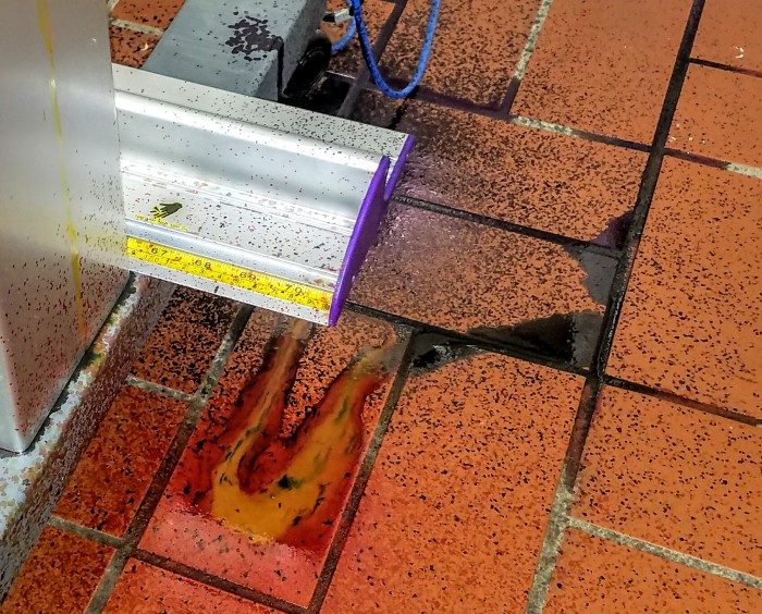

Unfortunately I went to a wedding and forgot about this (if it'd been my own wedding that would've been an excuse!) I left the cartridges out overnight and came in to this -
attachment.php
Apparently my cap tops all need replacing? (Of course I was planning on replacing all of them when I replaced this print head :covereyes:)
Anyhow, the floor cleaned up fairly wellish, and all printheads have been re-inked and are firing, doesn't appear to be any internal damage from ink. I really want to install this black ink head but I shot an unboxing of it and have the rattling sound on video, waiting to see what vendor says before going forward.
