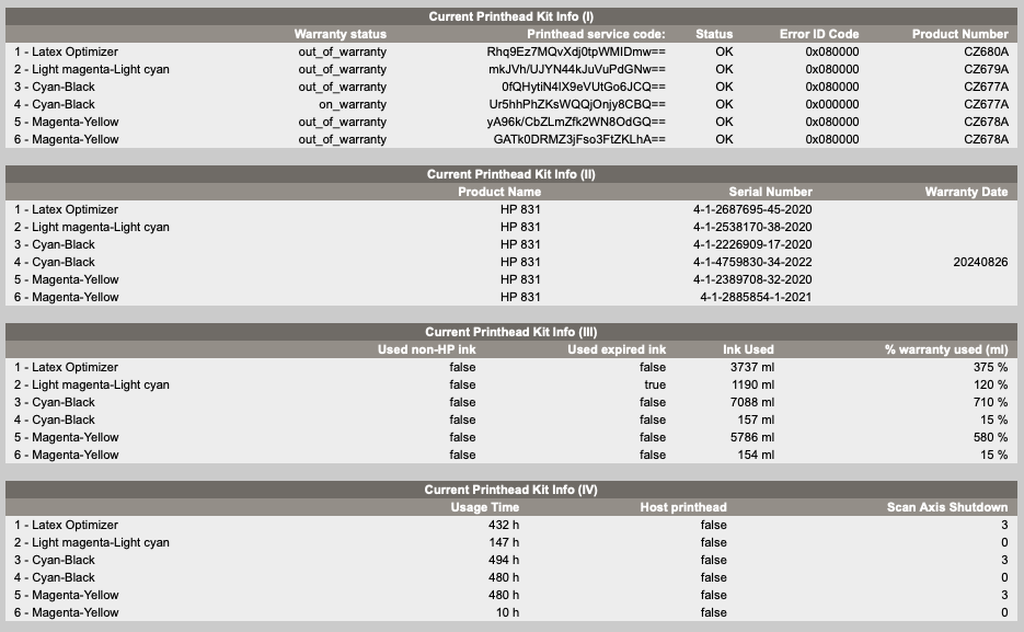

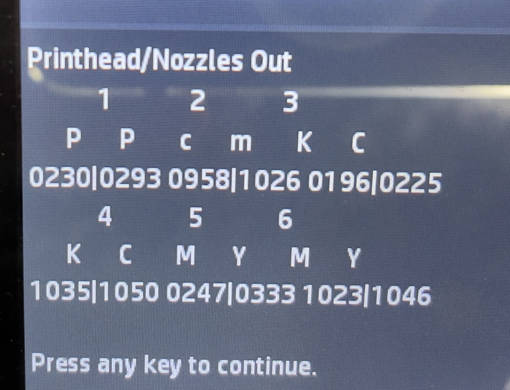

Force drop detector shows apparently different printheads than service plot. Are printheads numbered different in one than the other? I am sure I just recently changed #4 and #6 but why does FDD show them with the most nozzles out. According to the service plot I should be changing #3 and #5. It will be interesting to see what these reports say after changing #3 and #5.

No it simply means you have a lot of problems or DD is not working correctly.
Have you checked that inside DD there is no "Eiffel tower" of ink that blocks it from working correctly?
That many nozzles out, you Must be getting errors.
BTW you can see nozzles out in service plot as well.
