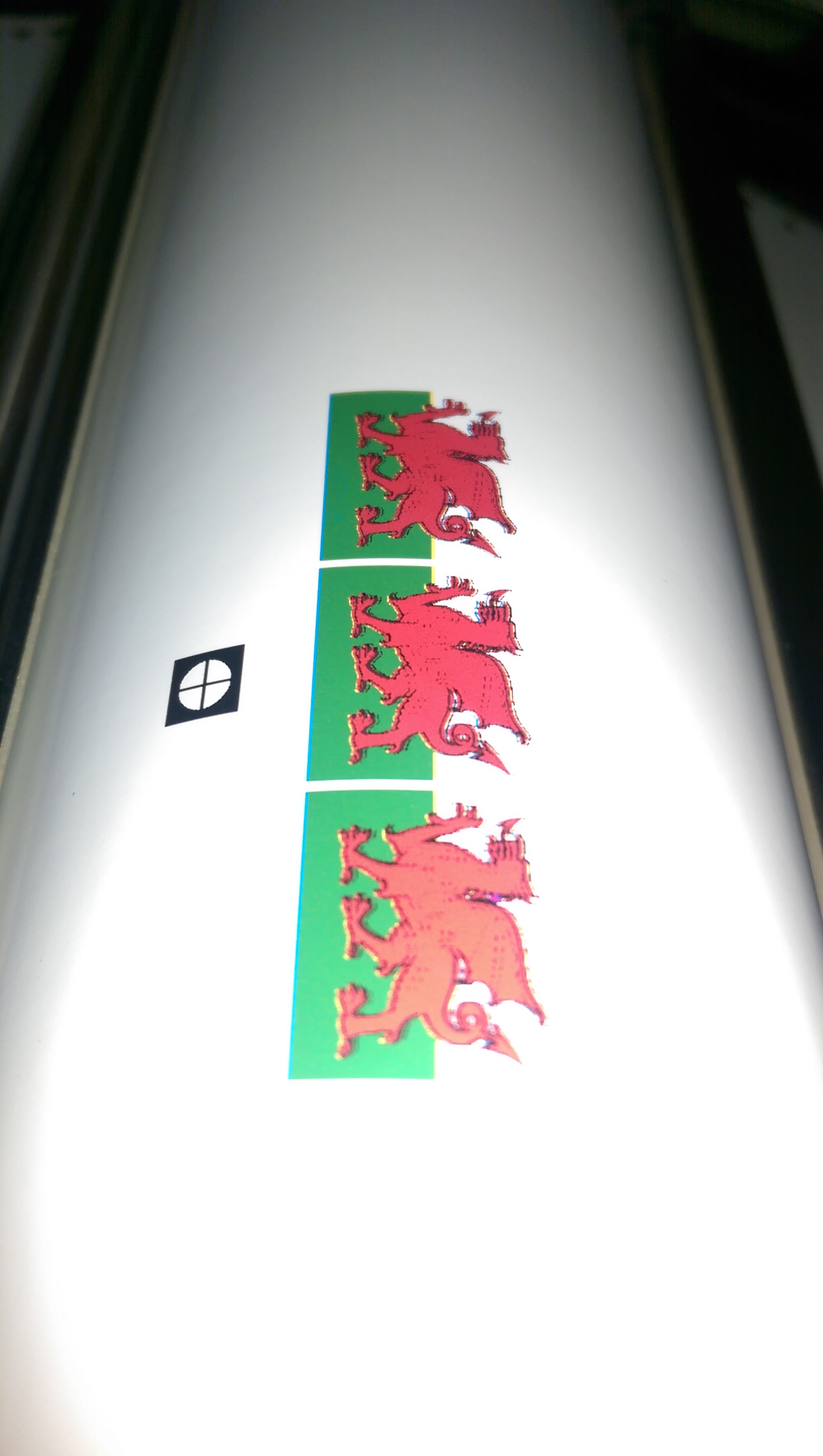

Hi, I'm trying to print some welsh dragons using CYMK but the print doesn't look right. The file I'm using is a vector file, I have attached an image, can anyone help me please. I'm using flexi with XP.
Bluestorm
ok I managed to get the printer to print the correct colours after some adjustments in the rip and print window, but now the image is blurred, can anyone help please?
AKwrapguy
With gerber you want to use 'Process' colors. But this is usually used when printing raster images. If their already vector assign foil colors.
