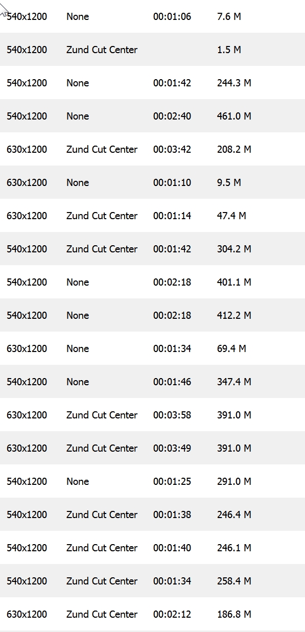

Interesting.
Here is what onyx is ripping to at about the 4'x7' size.
