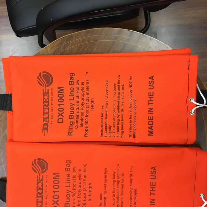

Thank you all for the replies and help. Here is a close up of the bag I took because you can't see it very well on the website.
