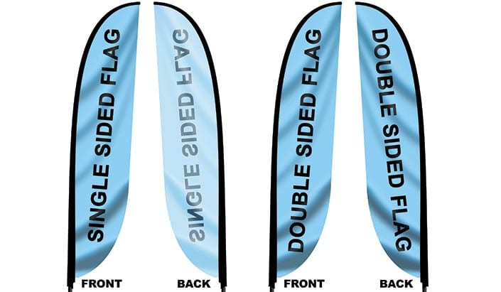

Good morning everyone,
I was wondering if the UCJV300-160 is capable of printing feather flag material, which I believe is polyester.
I mainly do printing on vinyl and die cut decals with the machine and I'm not sure if the printer can Print on flag material. I use LUS-200 inks. Also is there any material you guys recommend for this? Would really appreciate the help. Thank You so much. I added a photo for sample.
feather-convex-flag
JonaDoom123
Here is the example pic. I have a customer that wants 12 of these double sided and would like to make some profit if possible instead of outsourcing them.

I'm sure it will physically print on polyester flag material, but you likely won't get the same quality as dye-sub. We haven't really run into any material that it won't print on, as long as you can feed it through the machine.
There's also the finishing aspect....do you have someone in place to sew/finish these?

Hi thank you so much for the reply. I figured the quality probably wouldn't be the same as dye sub. It will all have to come down to testing I suppose. I do my father owns a upholstery shop and he does all the sewing for me when I occasionally get banners and people want them sewn and for pole pockets. Just the printing part that I'm kind of afraid of lol.

Did you ever get the UCJV 300 to print on the polyester flag material - i tried and it jammed up my machine?
Chrxs
I would UV-print the flag and assemble the flag later. Think your printer will do the job, which printing profiles do you use ? I'd suggest doubled paint application via printer rip if you only need standard colours! Did some jobs like this with the HP Scitex FB 550, decent results!

To avoid jamming the printer I am using a frame made of plywood to hold the fabric straight. I can just assamble the jersey / bannertex in it and print with no problems.
Chrxs
how do you do that on a roll to roll printer?
Nah sorry, my mistake! It was meant for a flatbed printer! I print Flags, Wallfleece etc. on the HP Latex 360/365 in top quality! HP gives you a "loading help" for soft / textile material for the machines with the help of this you can load the fabric/textile without any problems
