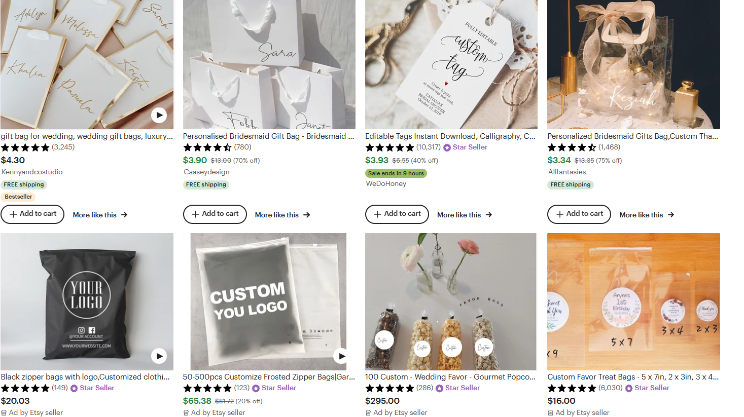

Stacey K
I like making signs
Etsy has what you need!
