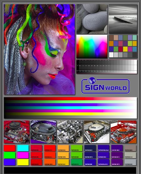

At the very least, you should complete the media profile creation process by printing a 'reference print' that validates the results. This reference file should contain things like gray wedges, raster and vector data, spot colors, memory colors, etc. Here is a screenshot of a PDF file that I use for this purpose.
