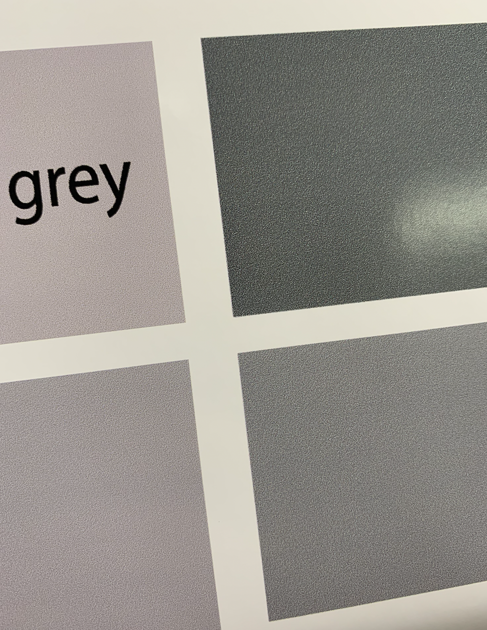

For this picture attached I went ahead and calibrated the color with the material on the self adhesive vinyl mode and it just comes out really grainy when we print under self adhesive vinyl as you can see. When we print with the PET film instead it is a really vibrant color for everything its just the grey is always getting the blueish tint.

Well there is a difference clearly then. How many passes does the profile have? What amount of colour?
Pet is different so it looks different.

This picture was with 10 pass and I have done 12 pass and even higher but it still does not come out as good as with the PET. I understand that is different and that's why it looks different with PET. I was just originally saying that all of the colors come out better on the PET and that's why I was trying to figure out how to adjust for the greys on the PET setting.
