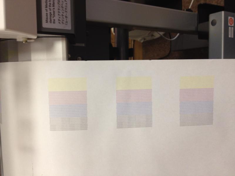

I have now started to notice that when I print large areas of Black I get what I think is called banding? All the other colours seem to be fined but I can’t seem to understand why the Black is slightly banding? When I do a nozzle test the print is ok but there are two block areas within the test that are ever so slightly faded??? Almost as if the ink isn’t getting through properly. (See picture)

The printhead touching the paper is a serious problem. that's called a head strike and will definitely lead to dropout. You shouldn't have any heaters or dryers on if you're printing dye sub so make sure the temperatures are shut off in the heater config on the control panel.

Hi Dana,
Thanks for the Reply. I am really starting to believe that the head is actually damaged (Replacement on the way). The problem I have is that the paper is all crinkled up in the morning when I come in, so I basically I just pull it through until the paper is flat again, but when i turn it on and the head moves across for measuring? the paper is sometimes slightly warps again. I think the heat from the printer is causing this but i am finding it hard to stop. I was told that sublimation needed heat to dry the ink? It currently runs at around 37 degrees. The room I work in can be very cold, is this a problem for the printer? That is why i have taken the precautions to heat the room a little. Thanks for the webinars link, I will most surly have a look at them.

You don't want heat while it's printing on the paper. Heat is used during the imprinting process. Now for solvent inks, I think it would be a different story, but not for sublimation inks.
