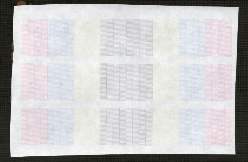

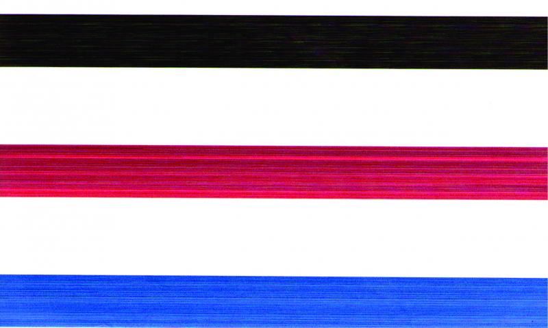

I came back to work on saturday, when suddenly i turn on the machine and i cant print properly.
here is the problem
when i print it looks like the printhead is clogged, but it isen't.
looks like strange banding.
here are some pics so you can check and tell me if you know what's causing the trouble.
Pic1: test draw with cleanings between them.
pic2: tested color per color to see if dampers are wrong (but all colors are having same issue, so....)
test draw looks strange like nozzles are not firing straight.. but you tell me.

I made:
Damper test / refill
clean cap station, change wiper.
made a nozzle wash, and leave it with cleaning solution for 24 hrs.
drop pos correct to align printhead.
manual head wash.
from what i know, it might be the cap station never changed it.., but dont know it for sure and can find a distributor here.
might be the printhead as well, mimaki support is telling me that vertical lines on test draw are not straight so i have to change printhead, but i dont believe these....

By the look of your test draw I would say you have a lot of deflections and a cuople of missing nozzles.
If you have enough deflections and they line up you will get the streaks that you see in your prints.
If you have done the head soaks and it is not clearing up I am affraid to say you may need a new head.
I hate to say it but I have had printheads that well have lasted for a very long time and I have had some that died after a few months thats the breaks with electronics.

Try replacing the cap head first for about $80 before buying a new print head. The overnight soak might not have worked if the capping station wasn't able to get a good seal.
Good Luck!

Ok, looks solved, not yet but its not the printhead.
Mimaki's people are telling me to change printhead for U$S 3500.-so no.
i put the printhead i have changed before (old one), that was washed before stocking, and it worked like these one. the printhead have no scratchs, no dirt, no missing or bad nozzles. Also i have a new printhead in stock, but no need to change it. it cant be so coincidece, that same problems, on both printheads. (old printhead was changed by mimaki people because of my ignorance.... NO MORE. (anyway im not a genius but trying to learn...)
cap is fine i cleaned all and it works perfect, look at pump works great as well, change 1 black damper, that was conflictive. (for damper use the DX.com Mimaki jv33 Damper, free shipping, U$S 4.- each, works nice for the moment.)
but it looks to be solved with a new profile. with better color organization drops.so i can hide those lines...
its not worth to change printhead. if you can make a new profile. and with some use the new printhead will also need to be replaced as well.
