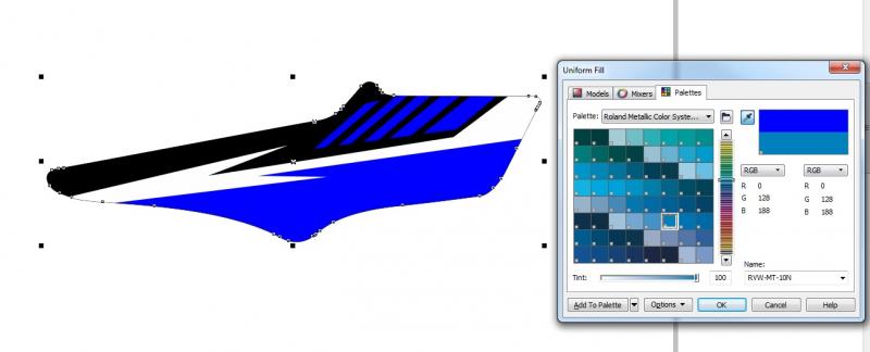

Here is a sample picture , I'm trying to use the same color of blue in MT. I don't see a blue simular to it in the chart specified in Corel X6 .
Is this just a color I can't do ? I also don't see a regual red as well , Do I just grab the closest color and hope for the best ?

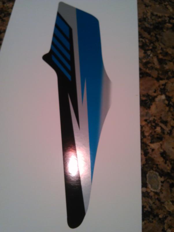

I ran a test , What I did was change the blue in Corel to a MT spot color. I printed it, the blue stayed as blue and the white changed to silver / chome ..
Only thing that I changed in Corel was the blue , so why white turned to silver / chrome I have no idea ??

In VersaWorks under the file format tab it will list all of the Roland Metallic colors in the file. Also in Corel Draw, when you have an object selected, it will tell you what color is assigned in the bottom right depending on your workspace.
