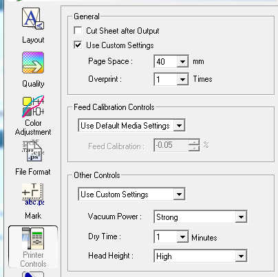

You could try playing with the Page Space variable on this screen:

I will have to check the page space as suggested above, as I have changed from roll to TU and still have to manually hit the switch between prints to reengage the take up reel. So much for automation vs babysitting.
Shadowglen
dropped from 40mm to 20mm space between pages and sent just 2 prints to speed up the testing. nothing space is still the same 4" and the take up still wont engage. Starting to have more faith in the cheap slip clutch style I have on my 540.
