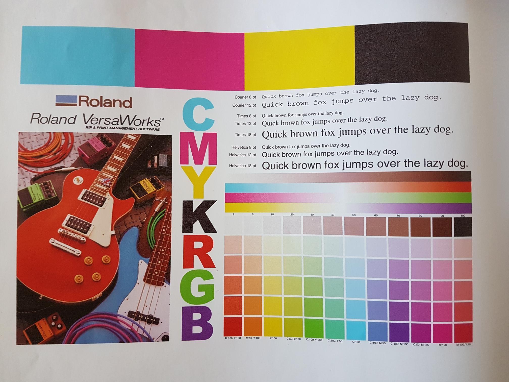

Ok I believe the problem is somewhere in my setting. as my test print comes out perfect but my files going to the back are completely different. My partner who did all the maintenance is gone. I have had to learn all the printer maintenance in the last 2 months. So I am guessing I set something up wrong.

Um, no, it isn't. Your cyan looks more like light cyan. Are you sure you have the right ink installed?
My first thought was, "Does that Cyan look super light or is it just me?" Also, you can kind of see in the Blue of the RGB that the magenta is overpowering the Cyan enough that it looks purple rather than blue. I'm thinking bad 3rd party inks maybe?

He wasn't asking if it's Roland ink. He was asking if perhaps you accidentally put Light Cyan ink into the Cyan slot on the printer?
We run a Roland here and I've seen that particular test print many times before. The rest of your colours look relatively fine but the cyan is WAY off.
