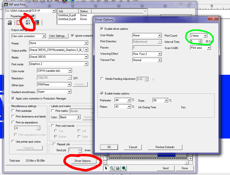

How do you double strike your prints in Flexi?? Or is this done at the printer - Valuejet 1604
I found the overrite cnt and wait settings on the printer setup menu but not sure how to activate it.
Printing on clear and wanted to try this.
Thanks!
see image below
attachment.php
