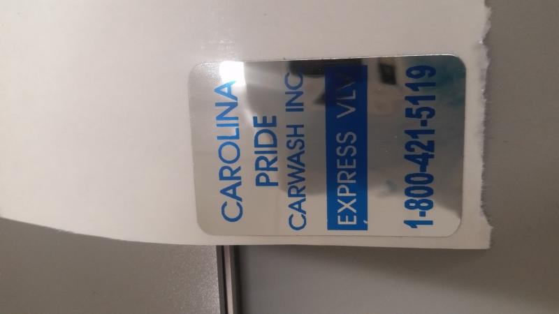

I ordered a roll of Oracal 951 Silver Lake metallic to do some
test prints on my L25500. So far the results look promising, but it's not working 100%. I'm getting a lot of pooling and blurring with the ink, and I have my heat settings turned up to what I use to print reflective. The vinyl is also curling and catching as it comes out of the printer. Has anyone printed on this or any other metallics with a latex printer and gotten good results? And yes, I know 951M is not listed as a printable film, but sometimes you have to think outside the box!
