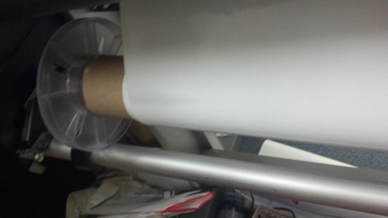

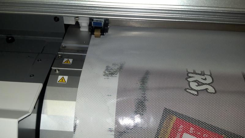

Okay so this is the second roll of perf I have tried printing on and I keep getting air pockets or bubbles while printing. Is this normal with Perf?

Yikes, no that's absolutely not normal.
Looks like the perf is lifting from the backing as it's printing? What kind of media and how old?
First thing I would do is tell your supplier to take that stuff back. Unless of course it's been sitting on your shelf for 2-3 years....but still.
You MAY experience a bit of buckling if heat is cranked too much, but from what I can see that's not what's happening here.
Thanks, I think it's the media itself. I have had another roll that did the same thing. As it prints it lifts off the backing before it hits the heat. The media is less than a year old and it's a generic film. Guess I'm going to have to find something a little better, any suggestions? Again thanks

Looks like too much heat on the platens for it to do that.

No problem. Have you tried turning the heat (almost) off on the pre-heater? When I've had issues with buckling this usually helps to a certain extent, you just have to make sure that print and post heat is high enough so the ink cures and you don't get any ink pooling. But I think either way that product is defective - too much silicone in the liner or not enough adhesive on the film. It shouldn't lift right off like that...ever.
