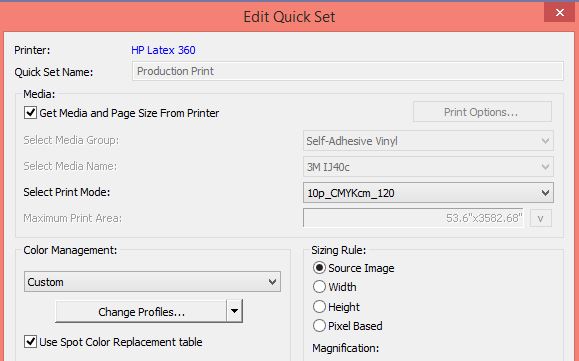

Actually, with ONYX Postershop and Adobe Illustrator, the hard work has been done for you by the developers of the applications. Both products already include Pantone Spot Color Tables in them, and that eliminates the need to take any measurements for Pantone PMS colors. All you need to do is to:
1. Use the desired Pantone library in Illustrator (solid coated for example). Fill the objects with Pantone colors.
2. Save as EPS or PDF, as these formats support spot colors.
3. Bring the file into Postershop using a QuickSet that looks for spot colors. This QuickSet selection is made in the Open dialog in Onyx. This means that the checkbox 'Use Spot Color Replacement Table' is checked in the Edit QuickSet dialog. Please see attachment for a screen shot of this.
4. In the Job Editor / Preflight dialog, choose the desired media product. If you make a change to the media, be sure to apply the change (at the bottom of the Preview and Size tab in Job Editor). The job will re-process the color mix based on the new media chosen.
The Sherwin Williams colors are not in ONYX or Illustrator, and they would need to be defined in both programs (design and Onyx). A pretty inexpensive spot color measurement spectro device can be used for this. I have been evaluating the Swatchmate Cube and it seems to work pretty well for a device that costs less than $200.
