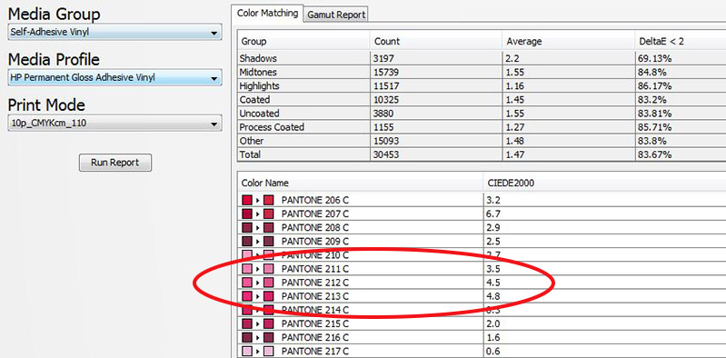

It is also possible to accurately predict the ability to simulate Pantone (or any spot color), using the Media Manager's reports and tools. I have attached a screenshot of this on the Latex 360 on a gloss calendared vinyl.
By the way, dE2000 of 4.5 is a pretty good, though not perfect match.

Thanks for the response. I have done 1-3 in my debugging. i have not used the media manager reports yet. i'm running them now. i'm assuming the higher the number the better? i research that. i'm starting to think its not possible to hit it.
edit- ok the lower the better. im liking this tool thx! lol. seems like HP profiles are giving lower scores than 3m. with hp air release cast im getting 3.4
Delta E represents the physical distance between two colors in the LAB color model. The smaller the number, the closer the match.
