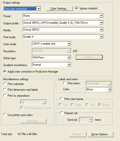

I use these as my settings:
I've tried using other profiles such as the 3M IJ180C, but on that one I experienced the grays came out with a little purple.
I've been using this profile on everything and I have not had any problems with my colors turning out.
I'm not sure if that will help, but it might be worth a try.
I will try it. I have been using graphics2 forever. What is the difference with Quality 4? Do you have the "color mapping" box checked in production manager? I just tried printing a swatch and it turned out the same as graphics 2. I am lost on this issue.

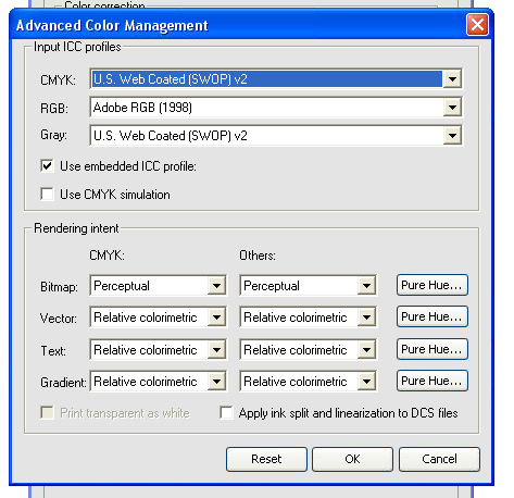

What are your settings if you go into production manager and click on the 3rd Tab over on the Job properties screen? When you click on the "Advanced.." Mine are Bitmap, Perceptual and the rest are relative colorimetric.
This?

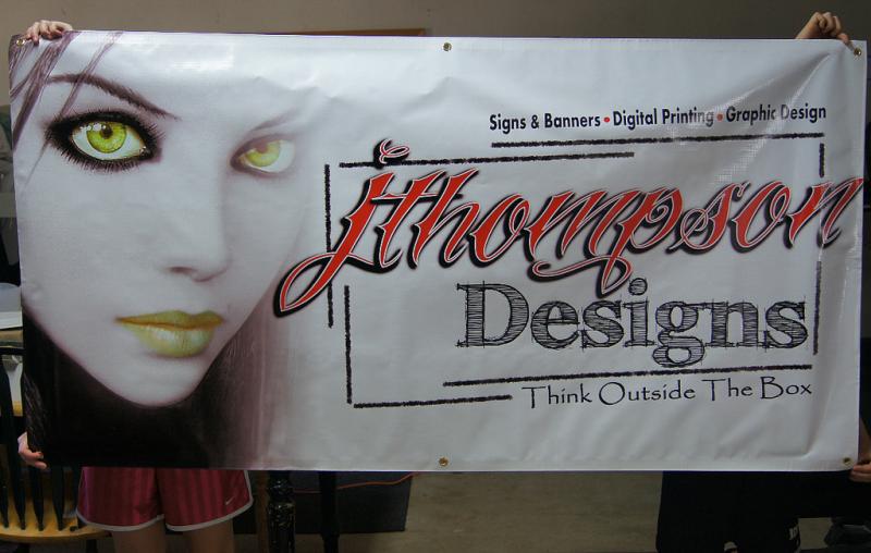

Try it without and see what you get? I don't and this is the red I get

Thanks, that looks fairly close to what I am getting. Mine looks a little more orange. Could the head height have anything to do with it banding? I always run it on High. My reds look decent in some parts of the swatch but it looks like it is not the same the vinyl. Almost like it is too much ink and it isn't drying or printing correctly.
