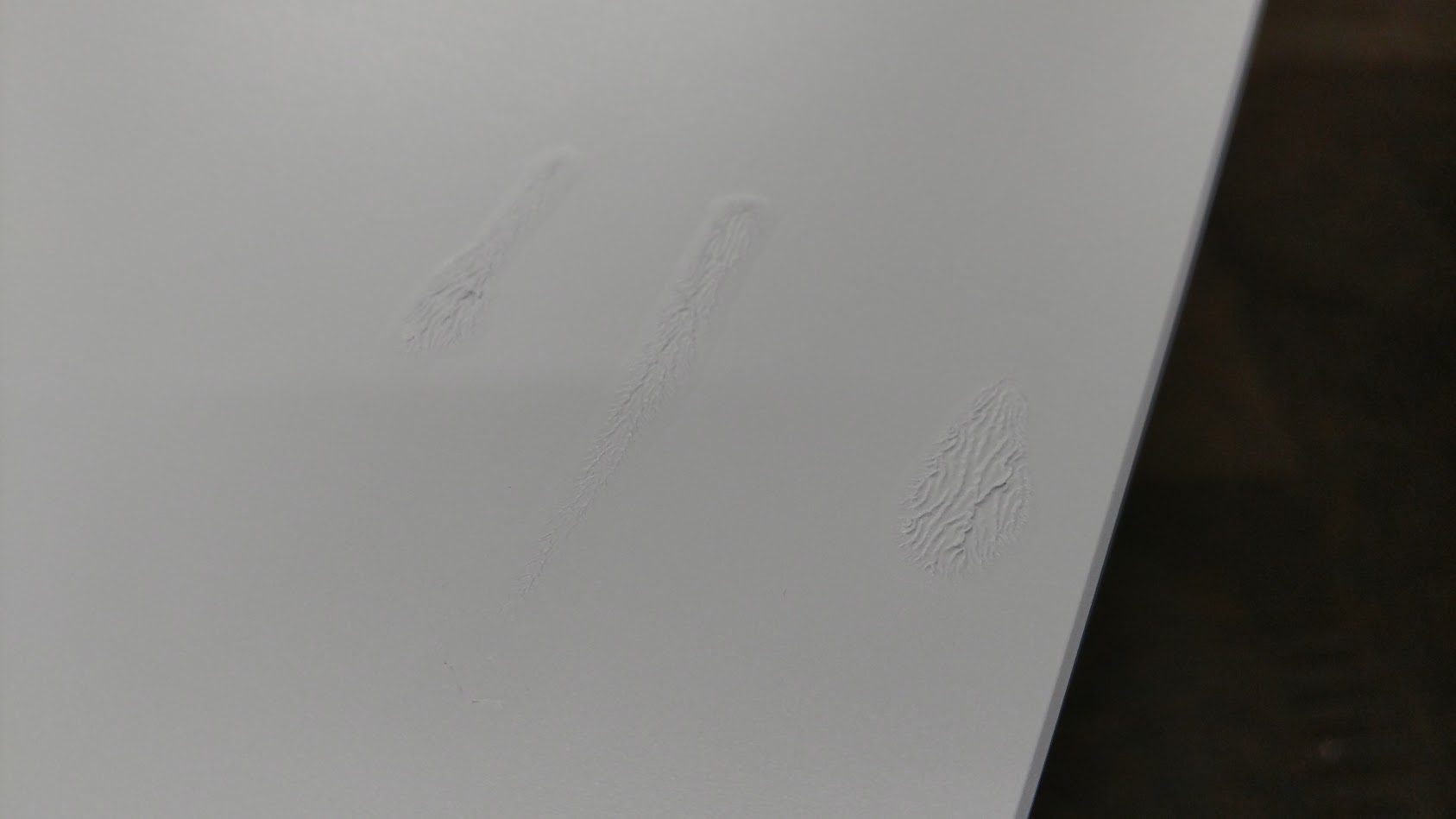

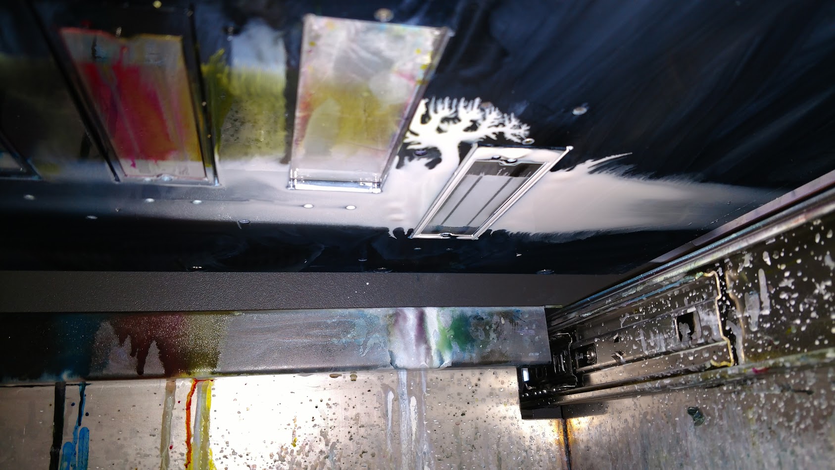

I have a Stratojet 4x8 econo shark. It works ok and has paid for itself. But, I can tell you from LOTS of white printing experience that it gets really tricky. That ink is really goofy stuff. You constantly have to play with head temperatures because just about everything can throw it off. I've printed giant 4x8 sheets of glass with a solid back flood coat of white over the reversed graphics. I've printed lots of spot areas of white and lots of things with "valid" image settings. The stuff loves to overspray. it's just really weird ink, that's the only way I can describe it. When you're printing that much white in that big of an area it can "condensate" (only way I can think to describe it) around the head area. When it pools up too much, it DRIPS... right on your print. You constantly have to battle indoor temperatures... head temps and subtank temps to try and get it to behave. It's definitely not for the faint of heart. If you're doing small pieces it's not so bad.
Another problem is, not a ton of people do that much white printing so when you ask the manufactures of ANY of the machines they say..."oh yeah... totally easy! Our machine is the greatest thing ever!"... you get the machine and start running into the issues and they go... "um, well, it might be this???? or that??? or?????".
The picture I'm attaching is of the head area on my machine... we totally cleaned it off before this was printed. - CMYK printing NEVER does any of this.

here are some drips.... It almost makes you think that screen printing or a spray booth might make better sense. But for what we do, this works out for the most part. But it does take a crap-ton of white ink. We actually lost an account because the manufacturer of the ink couldn't keep up with our demand. And since we were the only customer using that much white ink I am pretty sure it didn't make sense to up their production just for us.

Not sure... It was April 11, 2017 when that photo was taken. The humidity was maybe around 40-50%. But after the actual people who built the machine came out and looked at it (flew in from California) They messed more with the head temps. You might be right. I don't really know because I do not have all the data on hand to look at. If it happens again I will look into that.
