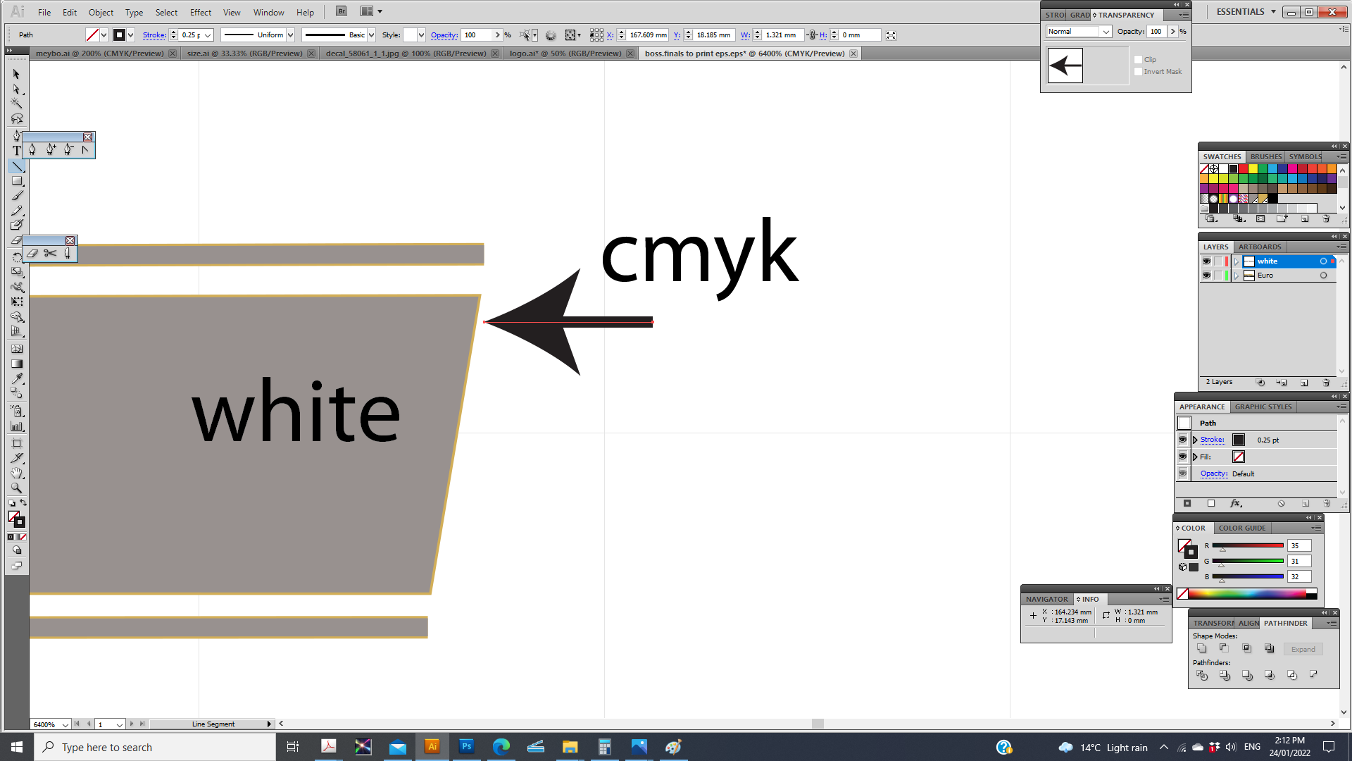

Easy as, copy the cymk image, create a new layer (white) lock the colour layer, make sure you are now in the white created layer then paste in front, fill with white as per your white ink swatch, then either offset the path with a negative value (say -.1mm) then delete the original pasted image which will leave you a slighlty smaller white.
Or you could simlpy add bleed to the cmyk layer with the fill/stroke (using stroke of say .25 pt)

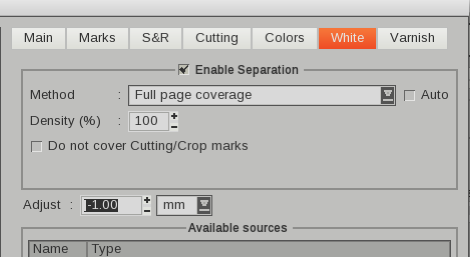

See my screenshot. Use the adjust option to reduce White.
It will take the border of where-ever you are printing white and reduce it. Even -0,1mm is adequate for white underlay for text.

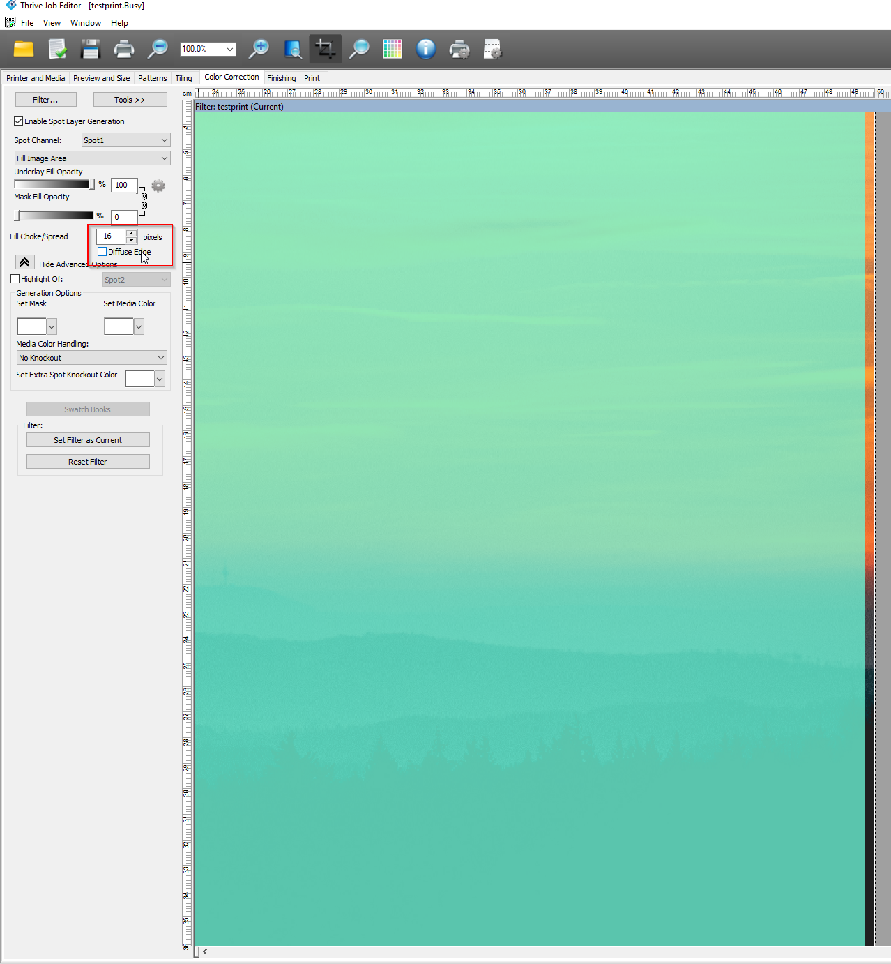

We use Onyx Thrive to rip our files and you can negatively trap the white by however many pixels beneath the CMYK output. The real problem is your head alignment though. The white is out of calibration relating to your color channels.

Negative is trapping inside and positive would be trapping outside the color. On our flatbed we ran between -2 to -4 pixels.
