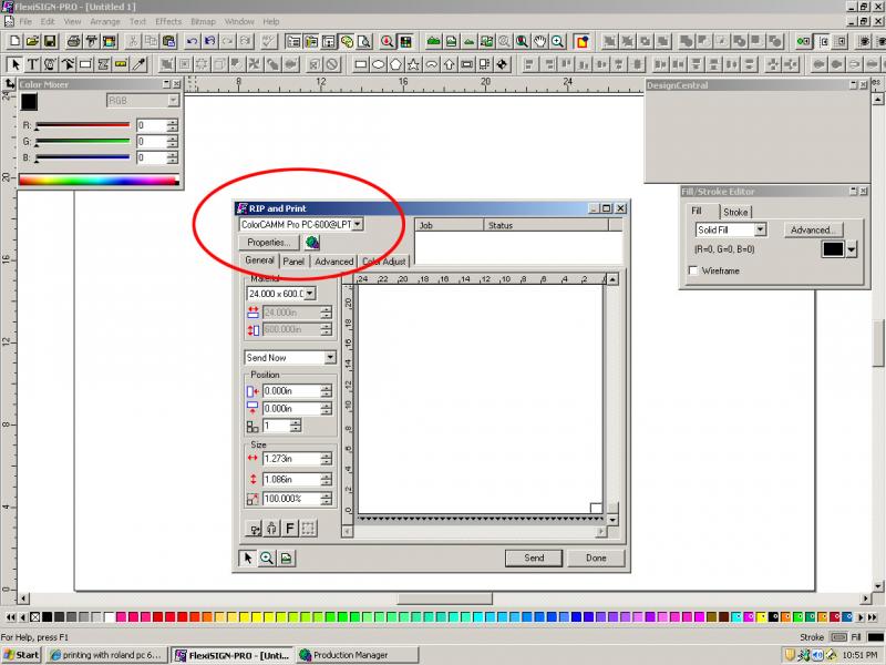

so i checked the settings and it is set on cmyk... i open an image in flexi and when i click print nothing happens.. i click RIP and Print ant the Production Manager opens i click send and again nothing happens..

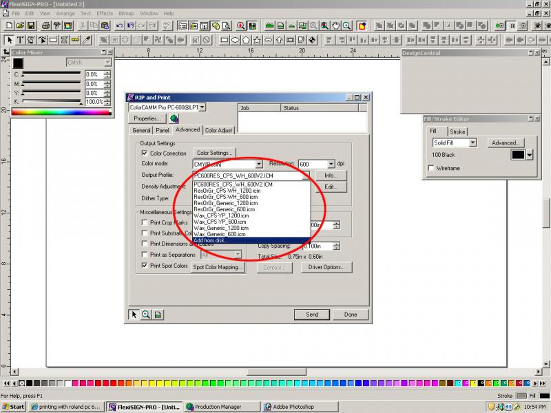

Sign Works
Have you even done a set-up in Flexi for the PC-600? During software install you select which output devices you will be using and this loads the profiles for that peticular device into Production Manager. Also the first time you click Rip & Print you select which port your printer is utilizing.
Sign Works
Printer Set-up / Assigned Port
Sign Works
Ya I know, it's an older version of Flexi, 6.5 actually. And yes my Windows display settings are historic also.
