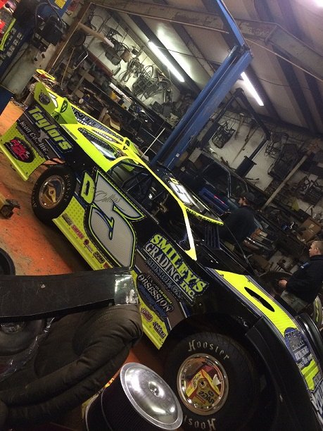

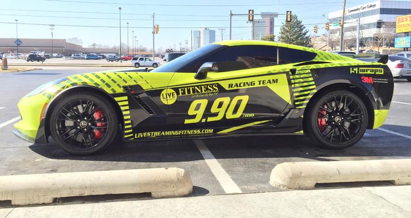

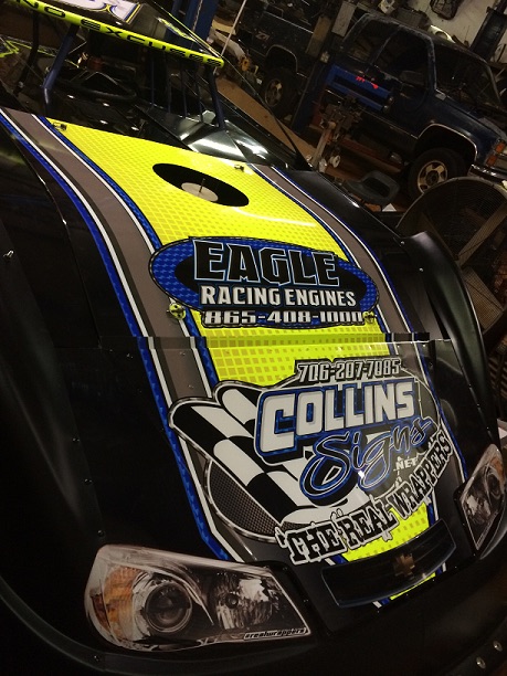

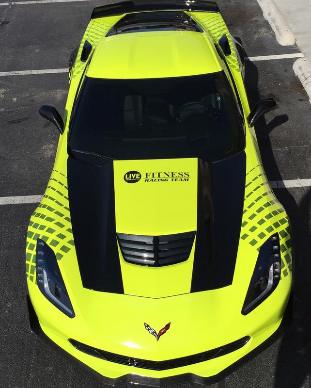

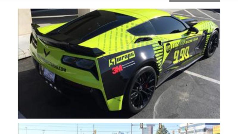

I have been seeing a lot of wraps. that have fluorescent color background with print on top of the fluorescent. Are people printing on say 3M 1080 film. Can you print on it with a HP latex printer? What am I missing here cause I thought these films were not for printing. Also I know of printing graphics with fluorescent vinyl cut and laid onto the wrap. But is it done before or after laminating? Also another question as I'm trying to figure out between glossing luster Matte laminate's (glossy and Matte I know what they are) i'm looking for metalflake Laminate's. Also holographic Laminates and where to buy them.

There are a few things here that are off. First, I haven't heard of any flourescent wrap films. Might be some nice brighter colors, but not flourescent by any means. Unless some have come out super recently that I'm unaware of. Next even if there is out somewhere, the fluorescent products loose that fluorescent glow in a fairly short amount of time, around a year or so. Most of the time, like on a race car for example, they are fluorescent overlays applied to the top of either like a 1080 series or a printed & laminated graphic. Laminate it first, then apply the overlays. Next even if you do get some fluorescent wrap film, like I know avery custom makes colors if you buy enough of it, then printing on it would still be an issue if you cannot print white, as without a white point as previously mentioned, your colors would be off.

I.m sure that is all printed. I can hit that color pretty much on L260.
