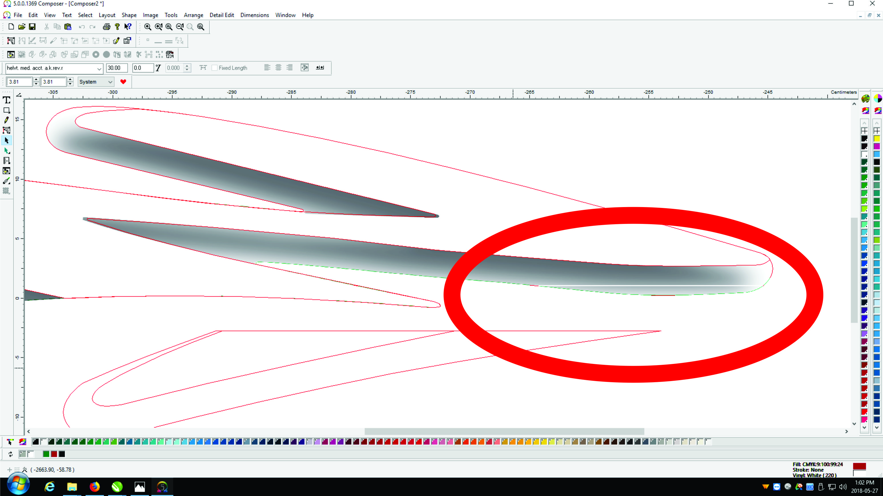

I am having a problem importing a EPS file from corel with a drop shadow in it
I keep getting lines n my drop shadow like in the screen shot
Anyone have any ideas ??

Hey, its because when corel converts to eps, it turns any gradients or drop shadow into little strips....you are better off breaking apart the drop shadfow in corel, then converting it to a transparent image...use a higher dpi setting if you are printing it larger.....
