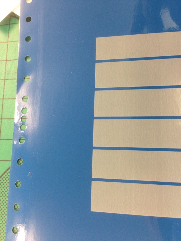

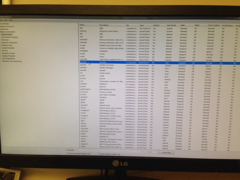

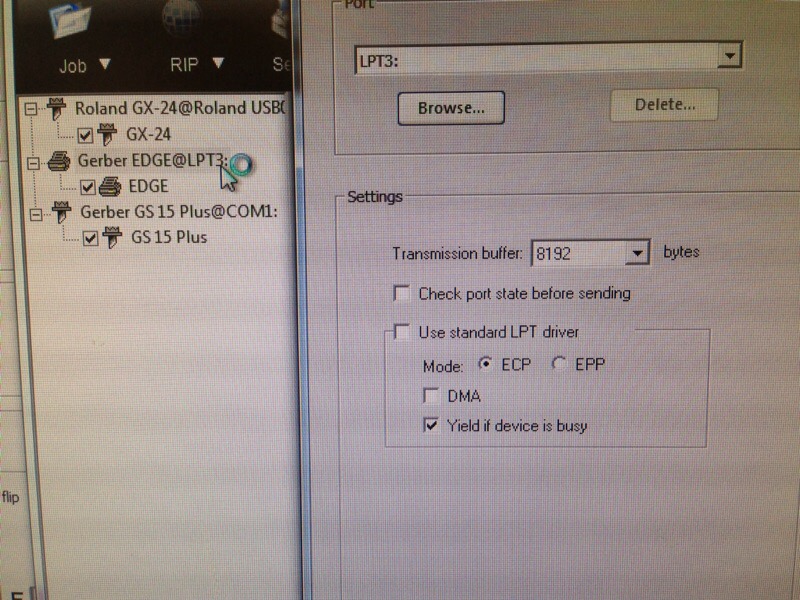

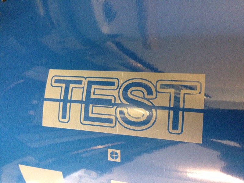

Currently I'm only using flexisign to print from when I test printed on the Gerber edge test prints are fine but when printing from flexisign I keep getting lines appearing through my prints please see picture one this was at 100mm x 280mm solid box. And pic 2. I have followed the instructions from flexisign regarding parallel port setting and unchecked the standard LPT driver box. I'm wondering if there's a problem with the warp 9 driver not working and the information is not getting to the Gerber edge fast enough hence the lines. I followed the instructions to remove the driver and then reinstall it but the driver is still showing as stopped. Please see pic 3.

warp 9 Driver Issue. the driver is actually called par1284. what I learned so far
as a default my parallel port was set to LPT3 If I send data to the gerber it prints wit lines across it.
if you view the state of the driver it says it is not running, thus its using the slower windows driver
which causes this problem,. but I found that if I change the parallel port to LPT1,
Go to Device Manager , Ports Com & LPT, Pci Parallel Port. Right Click Properties, Port Settings,
Change Port Number to LPT1,
Then Check System Information, System Drivers
look for par1284 State should read running. this means the warp 9drier is active.
But even though I have change the port to LPT1 and changed the Flexi Production manager setting to LPT1
Nothing is now printing to the edge, as if It's not recognised ?
will keep trying to solve this.

Which operating system? Do you know that the parallel cable is good? If not, try another cable. If there is a slot open in your computer, install a pci parallel card. If there is another computer available, try it. I have been using an Edge 1 & 2 for years with Windows XP and 7. No problems here. My setup in Flexi looks like this: Port - LPT1, Transmission Rate - 8192, Mode - ECP. "Use standard LPT driver" is not checked. "Yield if the port is busy" is checked. Good luck.
