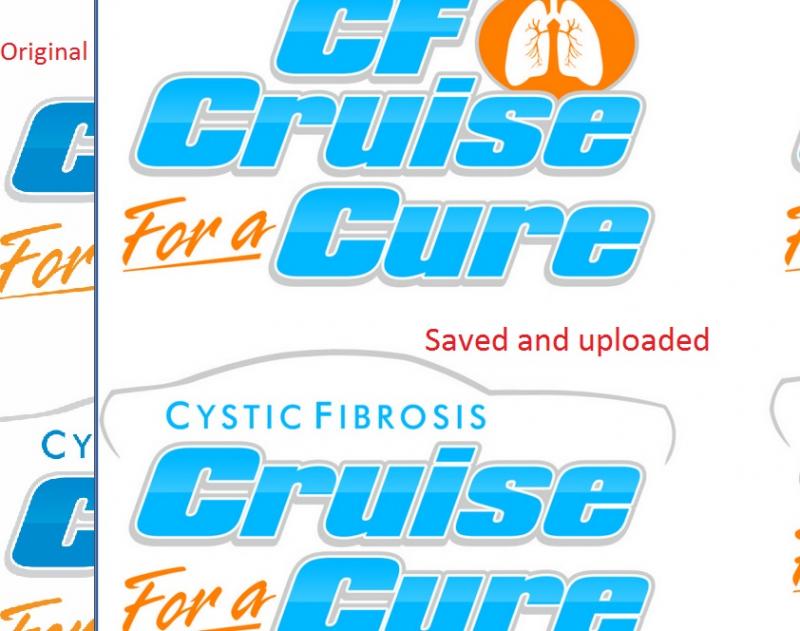

Hey guys, Using X6 and for some reason when i save a document as a jpg and then upload it via email attachment and or forum attachment it shows up as RGB instead of CMYK like it is when it's designed in Corel.
What i end up having to do is take a screen shot then paste it into PAINT, yes PAINT and then save it as a jpg there for it to display correctly colorwise.
Any idea why this is happening and how to fix it?
Left is how the images SHOULD look when uploaded and the right is the aftermath aka my problem.
Thanks!

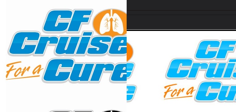

Anyone? This is a huge issue as i can't send proofs to my customers correctly.
Only way to to screen shot the corel file opened, paste into ms paint but i can't do that with multi page pdf's....
Have talked to Corel and reset the program, repaired it and all.
