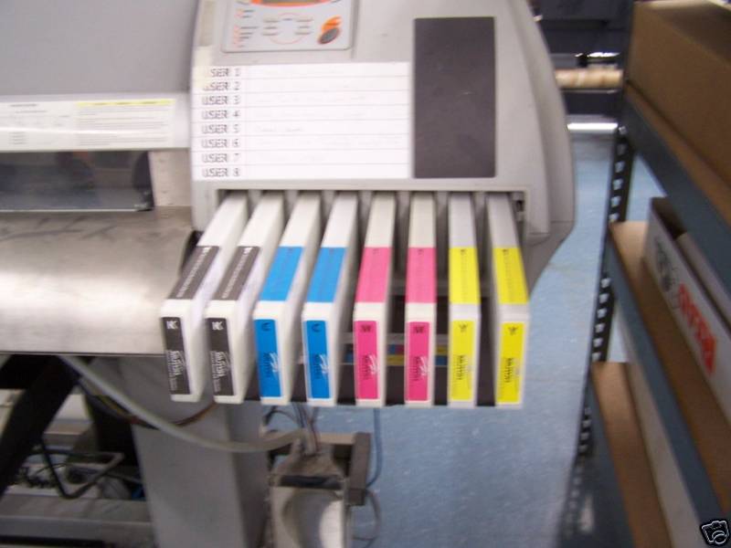

I just found this picture looking for some other stuff and this is of a falconII and it is running like I want mine but the manual does not show it this way. Can you set these up this way? If you can Please tell me how.

My guess would be you need to change it from CMYKLcLm to just CMYK, them settings will be on your printer setting on the main panel.
