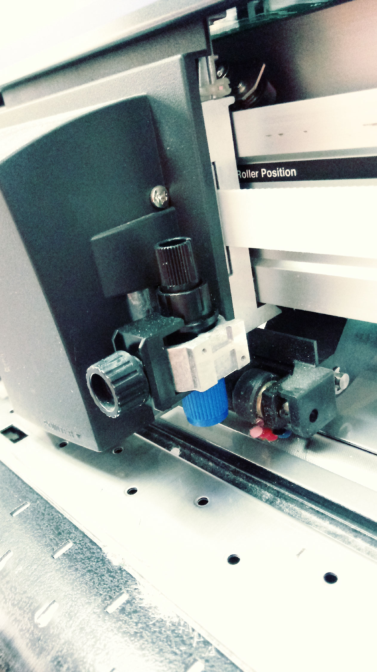

We've had similar problems. I think I've finally fixed it by changing the way I put the blade holder in. Haven't had the problem since I did that...maybe 6 months or more. Here's a photo (so, the flange on the blade holder is UNDER the black C-shaped piece, instead of on top of it). I hope this helps you. I still can't quite believe that's all it took to fix such an annoying problem!

Check the gap between the bottom of the carriage at both ends of the plotter. If it's higher on the left, then your beam is out of alignment. Gety with your dealer or with graphtec to get it fixed. Unless the plotter had been dropped, it should be covered under warranty.
