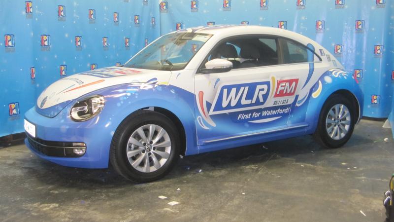

Des6139
VW Beetle, very challenging to wrap
I just fit wraps, I found this very challenging for two reasons;for some reason designers tend to go for a continuous image around these cars. These cars are very three dimensional, so what looks good on a flat screen needs to be taught about. The wheel arches had to be extended and then reprinted but i got it done,now just two more to do.
