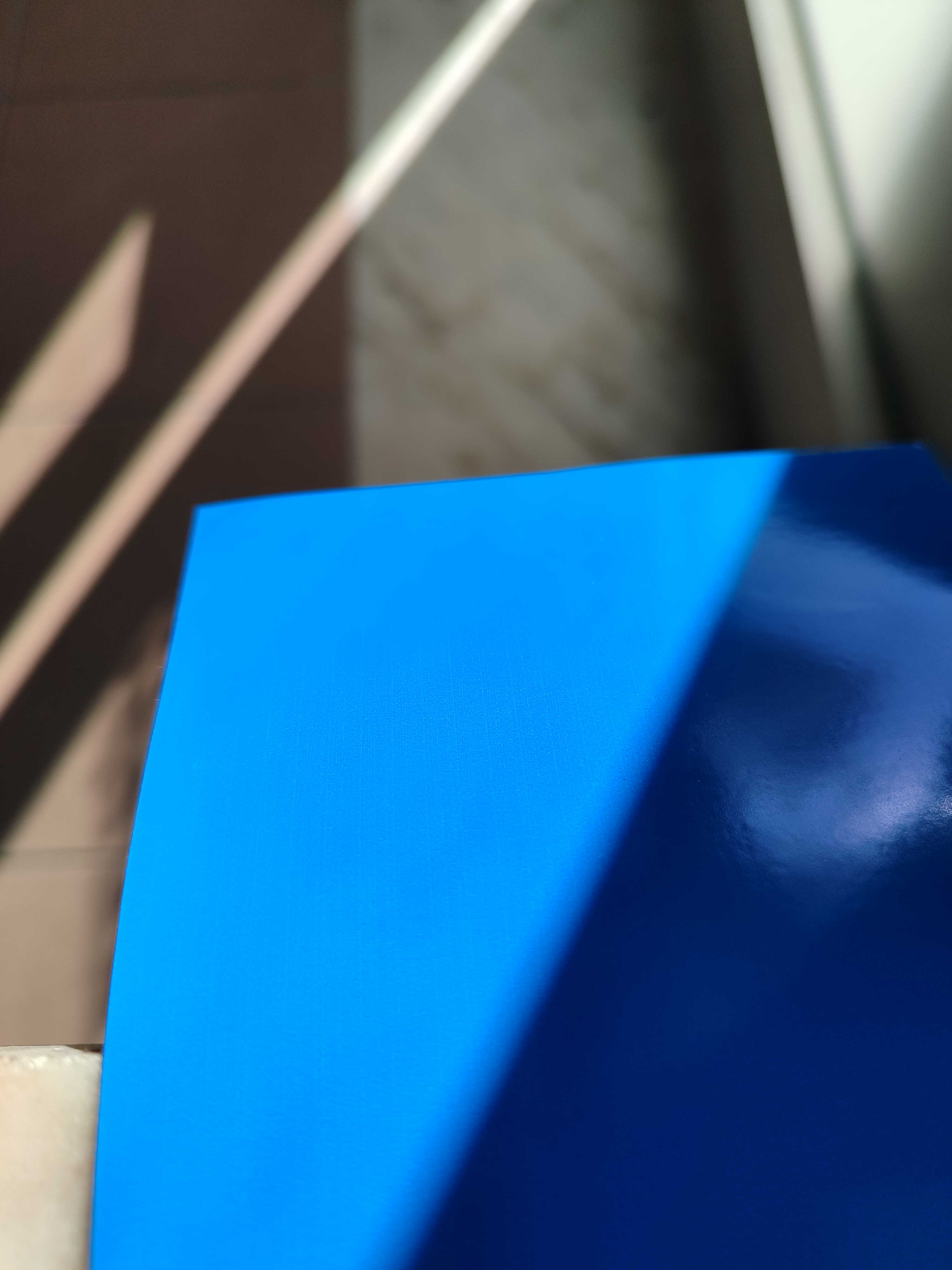

I need some help, my roland since I bought it the cyan has never come out uniform, it always comes out scratched, although the technician has already done numerous alignments and the nozzle check is perfect, a technician told me about a failure of the roland, due to the cyan paint being too abrasive ruins the head, have you had the same problem?

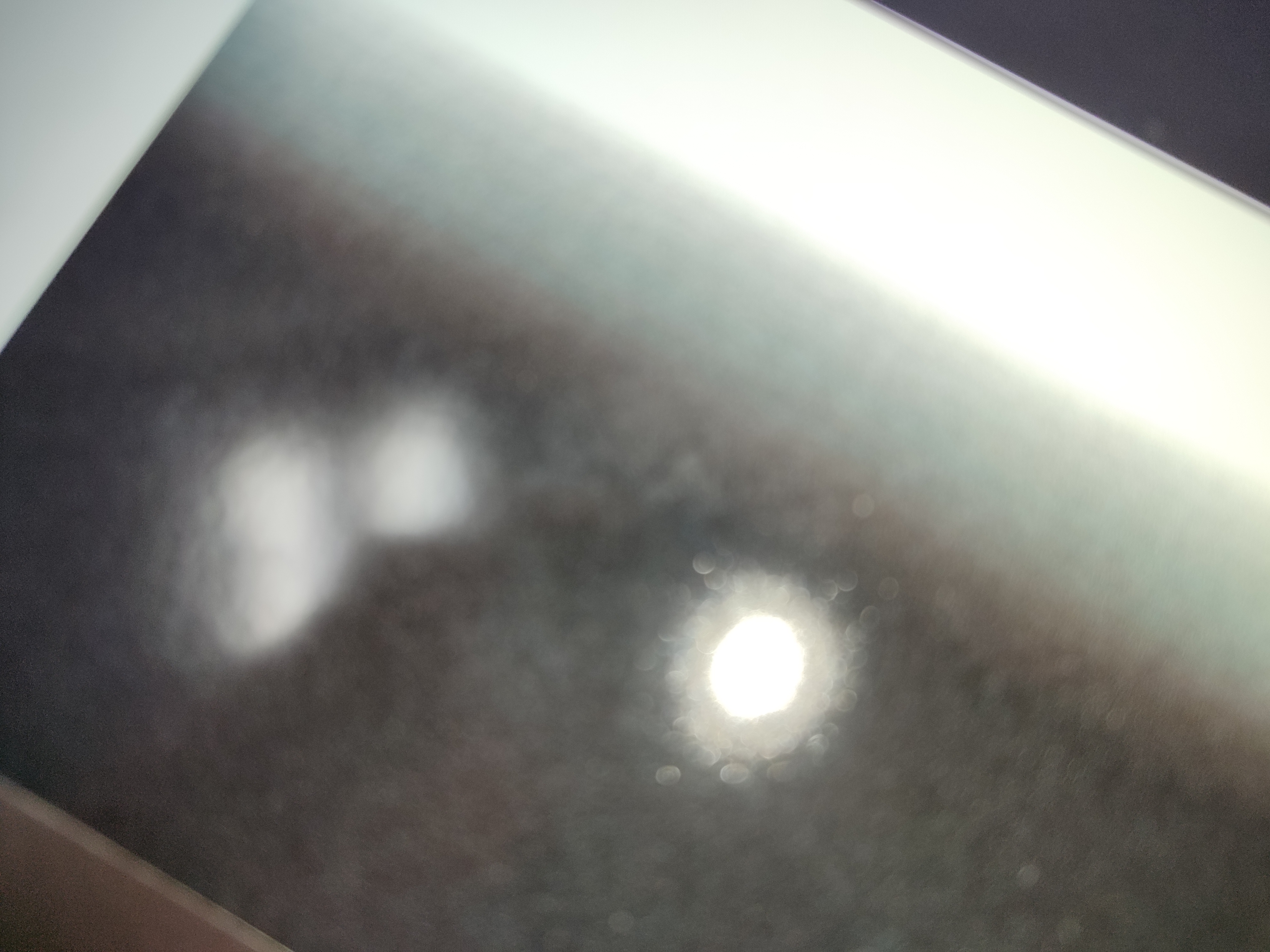

I am also having problems with the black on a vinyl that I use, for the motocross stickers, the black is not uniform. Note if there are always white spots on the vinyl, what could it be? lack of temperature? or the profile? or another problem? I really appreciate your help!!

the blue one cannot be seen through the image, but I send the black one

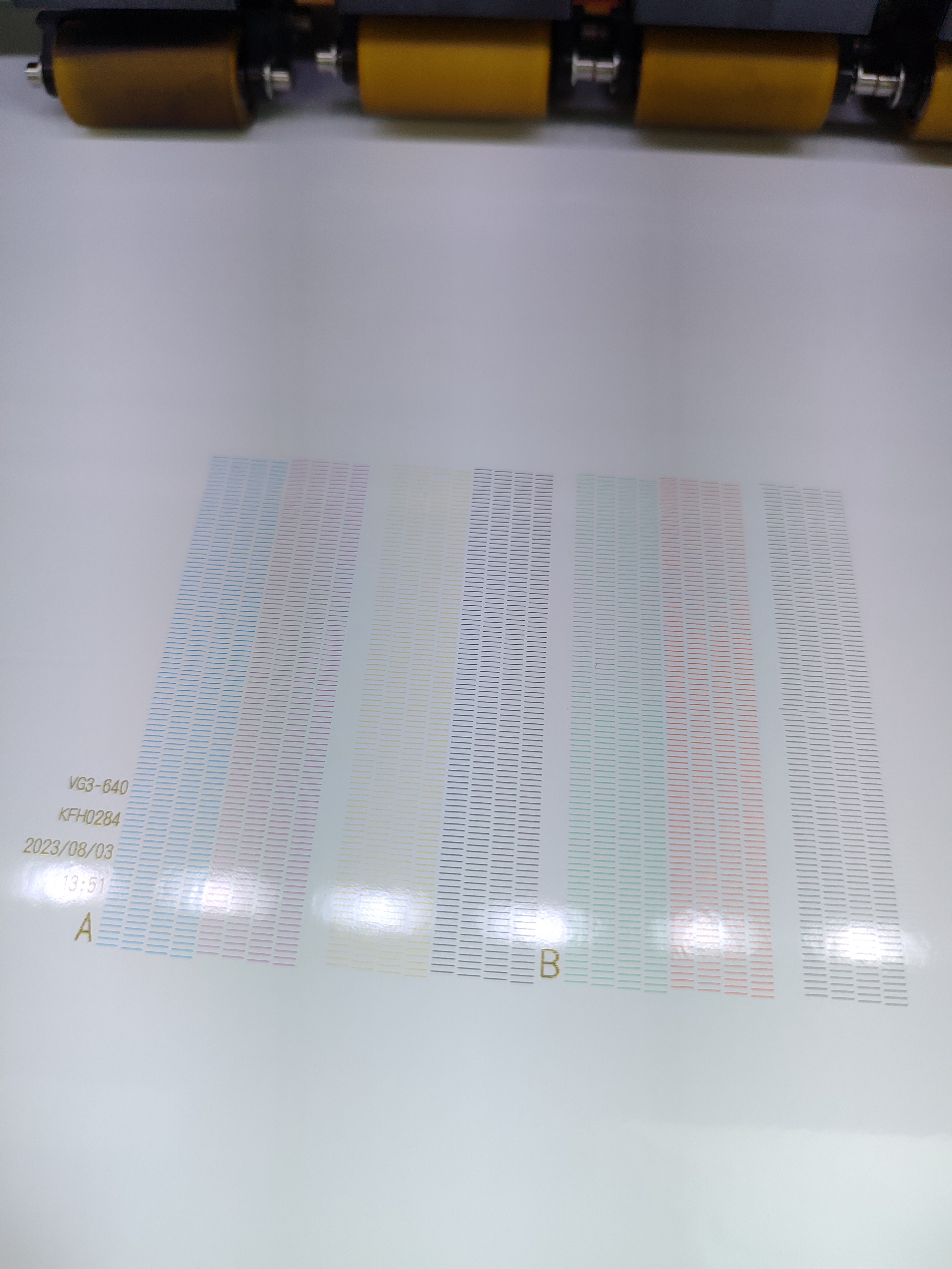

Have you played around with profiles, heat, speed, uni vs. bi - directional? Also that photo is very blurry and hard to make out. Would you also have a nozzle test?

black only looks like this on a specific vinyl, on generic vinyl it looks good, it looks better with speed than with quality but my biggest problem is the cyan
the print is not regular, it always has scratches as if it were problems in the head, but the nozzle checks are perfect

Doesn't really look like there are any issues with the nozzles. I'd need to see a photo of the cyan to know for sure, but you might just need to play around with settings if it's only that one media that is causing issues. Also, are you certain that media is compatible with Eco-Solvent?

When you say scratched, do you mean banding? Cyan seems to be a problem with newer Rolands in my opinion. I think the problem is caused by the damper.

No, cyan is a problem on all vinyls
The problem with the black is that it happens on the vinyl of susbtance and yes is conpatible, but i put ir on standard instead of high quality and i put the temperature Higher and it improved

In This photo if you zoom in you can see

My VG2 printed great black on just the Generic Vinyl profile but on the VG3 Generic Vinyl Profile the black is very Dark Grey with tiny little white specks still visible...
As ushe 3M doesn't have a profile for my CMMYKLKORGR inkset (use mostly 180c) so I found/am using the Arlon Graphics LLC Fusion Wrap profile and the black coverage is nice and even...its not quite as thick as the VG2 black coverage but acceptable till I do more testing...try the Arlon Profile, the ink coverage was totally different than the new Generic Vinyl profile.
