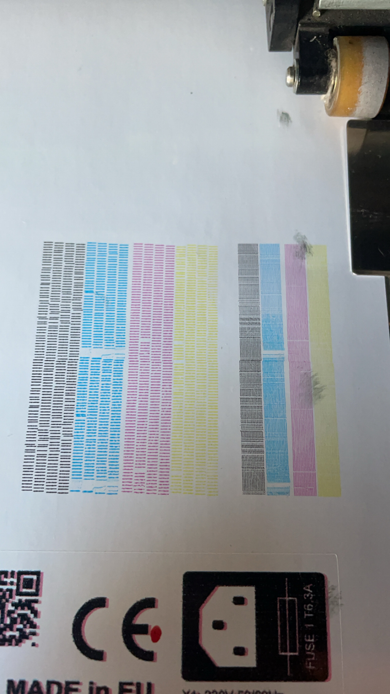

Hello.
I did all the calibration and adjustments and settings and after second row of labels the cutting is not in the right place like 2mm and third row already 6mm
And the sheet it start to go to the right side so the left roller is almost off the sheet.
Anyone have some ideas. Priblem with rollers? Or something
cornholio
The plastic part holding the roller is highly likely brocken. Check for cracks, that open, when you lower the pinch roller.
Jim Hancock
Old School Technician
Based on one of your pics on your double photo thread, your pinch rollers are in serious need of cleaning. Use a foam swab and alcohol. And clean all the debris from around the roller shaft. As everything moves faster when cutting and the back and forth movement of the media, dirty pinch rollers allow for media slippage, which will give you the problem you described...
