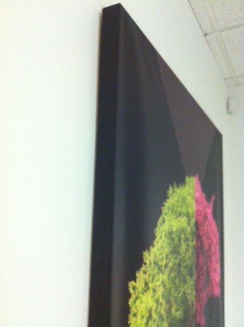

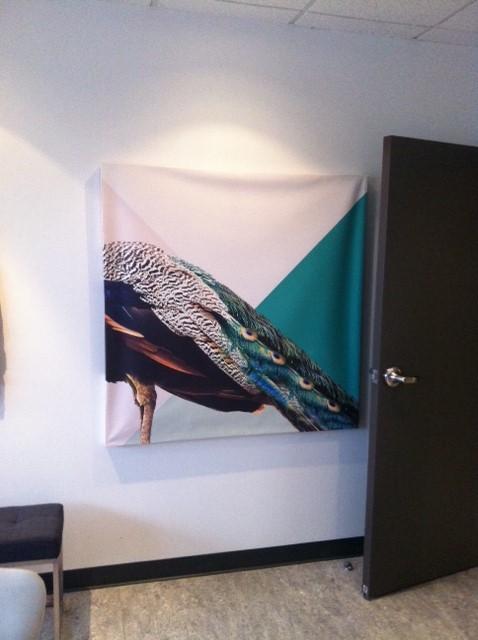

Hi hope someone will be able to help me with this. So I've made those canevas mounted on frames using the IG wrap system. I've delivered them in December but the customer just put it on his wall this week. At the delivery, everything was fine. Now the tension has loosen up alot. It look like the material have stretched for some reason.
I've google the problem and I've read that it is a humidity problem. If I spray water on the back of the canvas it could go back to normal.
Does anyone ever had this problem and have a solution?

I have been stretching canvas over a year now but i use the tongue and and groove bars, yes the water would fix some some loose areas but your photos look like a major tension issue is it really dry in that office?
I have not used IG system but is it possible that it lost/move its contact to the bar? as only adhesive holds it (as per video form vimeo), did you put alot of tension when installing it?
When i stretch i make sure that there is only enough tension then strike the bars outward to stretch after stapling then biscuits to secure the inside corners.
What type of canvas material did you use? In my experience water works well for 100% cotton canvas.

The IG wrap system use stapler in the corner and biscuits to hold everything. I've done maybe 200 frames with this system and it's the first time I encounter this. The canvas was fine in my shop and was here maybe 2-3 days before the delivery that I've made myself. When I left their office that day, everything was fine. I don't know where they put it for a bit over a month, but I know they installed them just last week. At the delivery, I've wrapped them in a plastic bag individually for protections and I've put corners protections too. Is it because maybe they left them in the plastic bags all that time that could cause this?

I'm not familiar with the IG system, but my first impression is the that those prints are too big to not have crossmembers in the middle.
That is way too much sag to think a little water and shrinkage will fix it.

I watched the IG video, and having stretched a few acres of canvas, i found this system borders on ridiculous. Not only is it clumsy, it's mechanically unsound. The canvas ends up trying to be anemically stretched an entire side at a time. This is not a sound way to stretch canvas. Especially if you want it to stay stretched. Hence the OP's problems.
Canvas is proper stretched by stretching and fastening the center of each side then working outward to the corners. If you know how to do it, and it's not rocket surgery, with a staple gun and a pair of canvas pliers you can properly stretch canvas faster than you can remove the tape from those silly, and no doubt hideously expensive, IG bars. Moreover, once stretched this way it won't sag.
There is seldom any substitute for doing something right. Spare me the unsolicited testimonials to this dubious system. No amount of praise makes it mechanically sound. It's not.

With that been said, I've went to the customer this morning and it seems that the biscuits have loosen up. I just use a hammer to put them back in place and all came back to normal.
