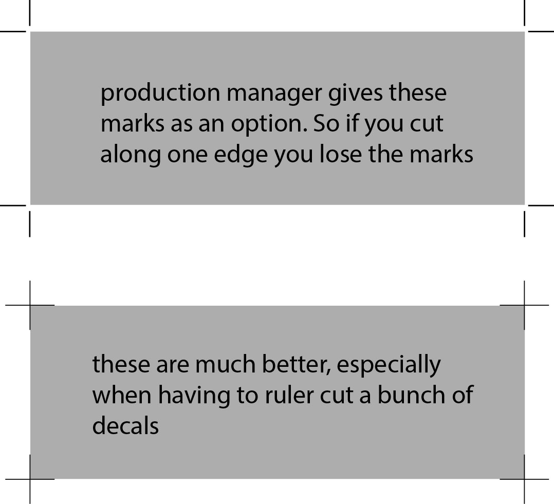

In production manager when setting up a job to print you can add crop marks so you can cut up the job afterwards with a ruler. It only gives the option for the outside marks and not the cross type mark, so if you cut one edge you lose the marks for the next cuts.
I have attached a jpeg to show what i mean. Is there anyway to get the cross marks like in the illustration ?

There are different cut marks for different plotters, I do recall that. I don't have access to the program at the moment to test.
One easy work around (the one I always used) was to draw a box the size the product needed to be with no color fill and a black stroke. Your cut lines are there and you don't have to worry about crop marks.

Try the one called Margin Marks. That is as close as Production Manager gets to what you are looking for and should do what you need.

The "Margins" mark is what you're looking for. Works fine for small stuff, things over 5ft I do "Tile Trim Lines."

these are better crop marks for this. Made with one click using a CorelDRAW macro.
