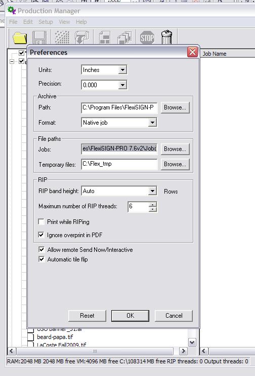

You might also check where it is keeping it's temp or "hold" files and empty out that directory.

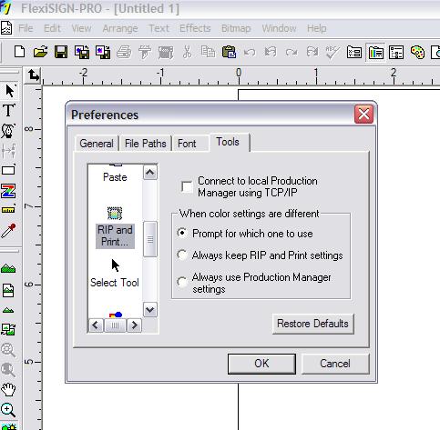

If your PM is on the same system as your main Flexi program you might check to see if "connect through TC/IP" is unchecked. When mine is active the PM can take a long time to load and some times ends up not loading at all - even when the task manager shows that App2.exe is running.

Both these options are in the "preferences" that you open up from the "Edit"
menu drop down.
One is in the main program and the other in the Program Manager.
I also remove most of the files from my job folder after I make sure I no longer need them or they are in the archive directory.
