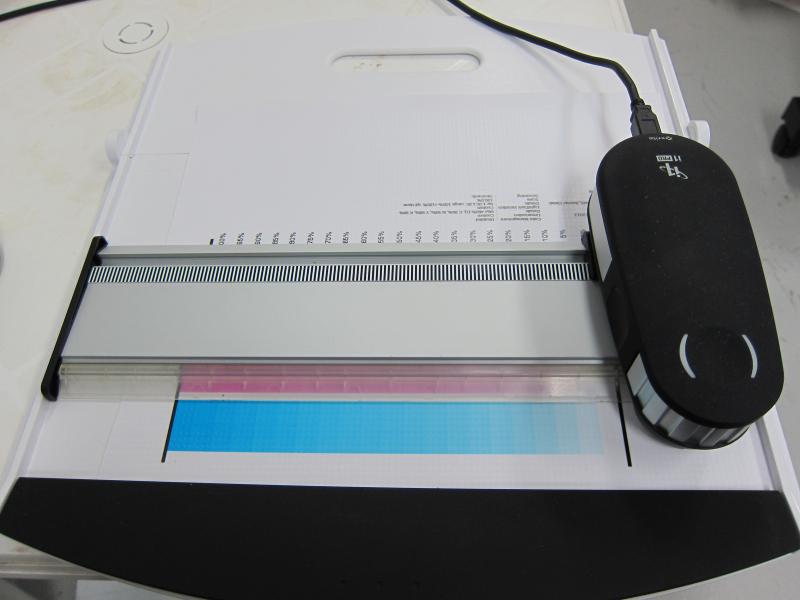

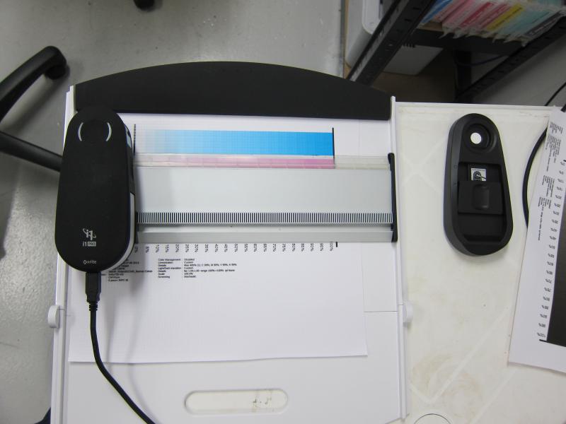

You should be set up similar to my pics.
>Place the printed chart in the holder with the ruler underlining the first line to be scanned
>Scan the white tile
>Position the i1 to the left of the black line in the holder
>Click and hold the button for a second
>While continuing to hold the button, take approx 3 seconds to scan across the chart
>When past the second black line, release the button
>Wait a second, then repeat the same procedure going from right to left (the light on the top of the i1 will be flashing red on the left hand side)
>The i1 lights will flash green when performed correctly
>Shift the ruler down to the next line as instructed in Caldera, and repeat.

I got that to work. I am working through my first profile now. I am at the dynamic target print out. What would you recommend if it is laying down way too much ink? All of the other scans has nice smooth curves after the scans so far.
